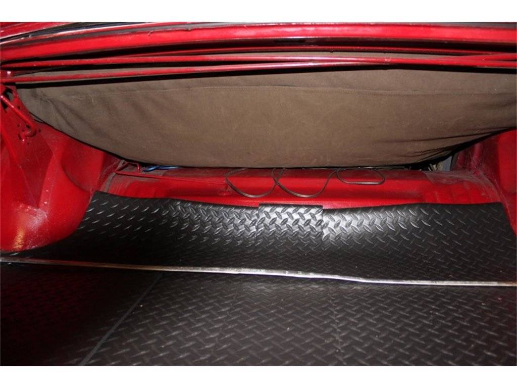

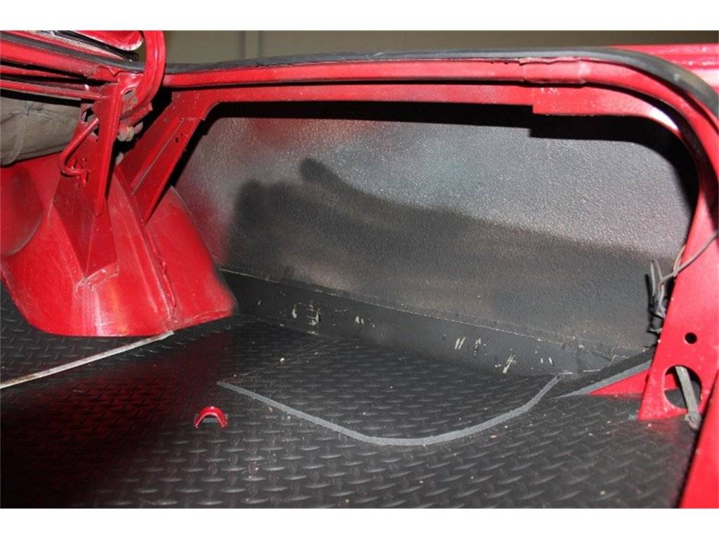

There are some brackets in the trunk area that you stick the bent end of the bar into.
The other end has a white plastic square slider (not a roller) on it which pushes yp against the trunk lid's hinge arm. The sliders are available in reproduction.
Here's some not very good pics from the net:
Hopefully this helps show you how they fit. Note that the slider in this car's pics are covered in overspray.
View attachment 201474 View attachment 201475
thanks for the help....will look later today. cheers ian
