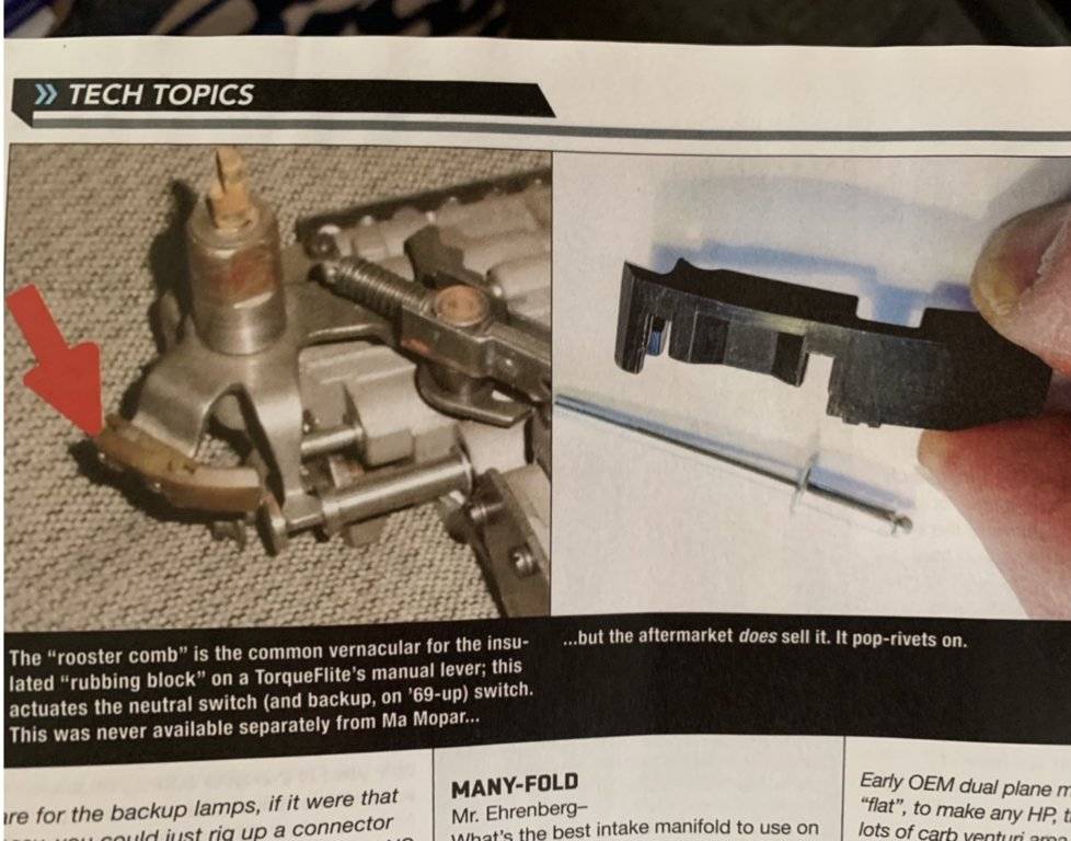

Usually when these leak, it is because the gasket at the base of the switch is bad. Yes the center pin on the switch is for the starter circuit. Single pole switch is still available but costs about $65. If you google "single pole Mopar neutral safety switch" suppliers come up on E-Bay. I would probably use the single pole switch because on some applications you need to change the shift comb inside the transmission to get the the 3 prong switch to work properly. Not sure about your '66.
