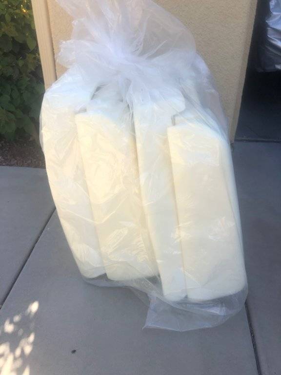

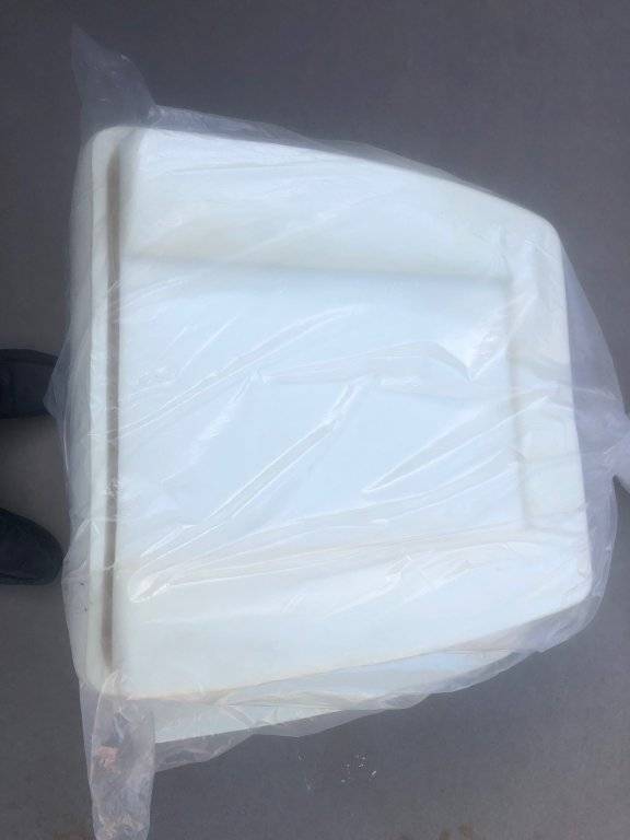

I have the foam from Legendary I bought 2-3 years ago still in plastic and the box which was somewhat crushed ( but no tears) and no damage to foam (big box with no internal support so box crushed easily). The person who did my seat covers from Legendary (great product) wanted and did his own foam. Bottom line, the box is in my way and I need to get rid of them. Make me a ridiculous offer plus shipping and you could be the proud owner of spanking new seat foam. Legendary would not allow me a return, time elapsed, but in the discussion said they also fit B Bodies
I do not have a supply chain problem. Pictures if you like.

Looking at pictures on the internet, it looks like the 66 seats might be slightly different than the 65 but that is a question I can't answer and someone on the forum might have that answer. As far as the foam from legendary, for the 65 it can be found on Page 47, Part #MF60ABCSET of their 2021 catalog which fits a 60 - 65 B or C. I have attached a picture of the foam I have for what it is worth. I ordered it in anticipation of redoing my car and when I finally got around to it, my upholster said he would rather trim his own because they usually needed trimming anyway?
