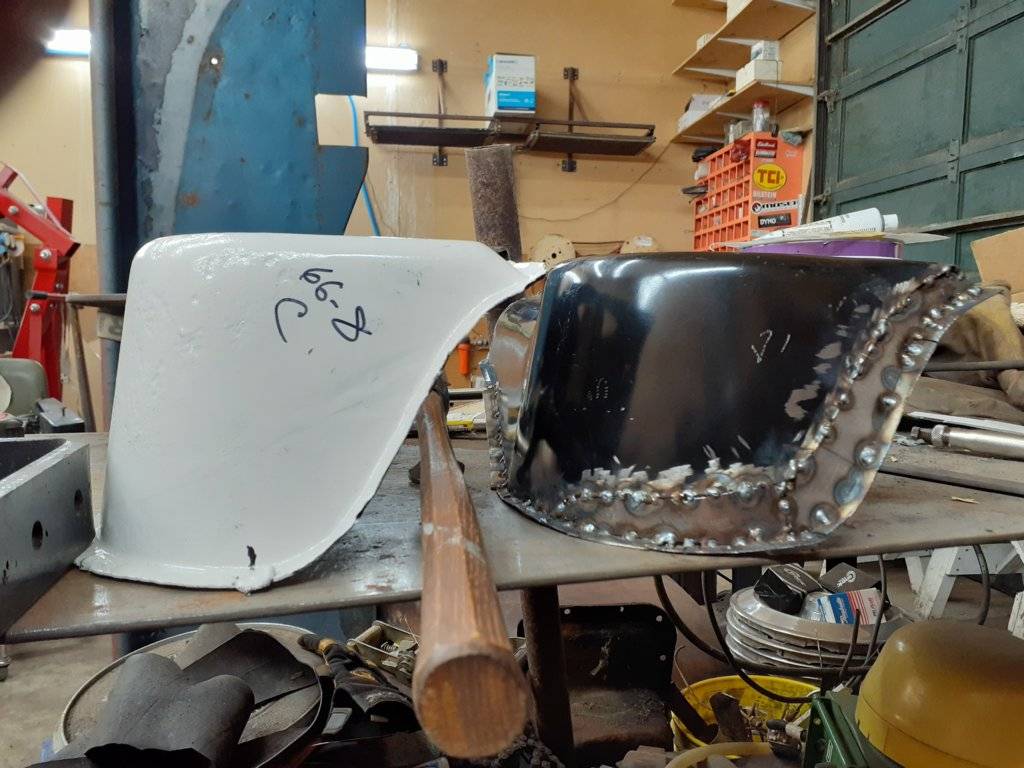

I converted a 66 to 69 b body hump into a 66 to 68 c body hump.
I have a original c body hump and a floor pan for mock up. These 2 things make it quite simple.
Trying to convert a B into a C by the seat of the pants would be task.
I set the c body hump in place and put a line with a sharpie around it. Then modified the b hump to fit.
This picture shows how much needs to be added to the rear area
The left side needs to be trimmed.
The right side is pretty well ok except for the front.

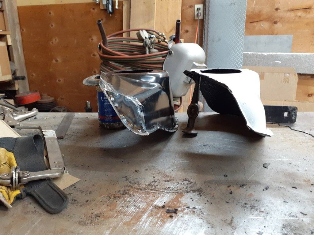

This picture shows the front.

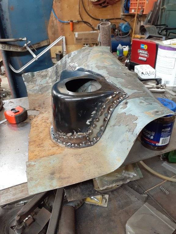

I had to add a wedge in the top.
also make a new front. The original is curved. I used a flat piece.
There is aprox 3 to 4 inch of the B body hump that I left alone. Easy to see in the lower front.
