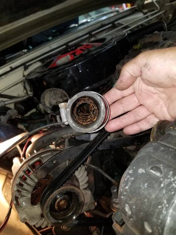

Thanks for the tips everyone to the no heat issue. Simple problem was the cooling system was all plugged up with lots of gravel and rust. The one picture is the inside of the upper radiator hose and the other shows a plugged Y pipe from an old frost plug heater circulator setup. The good news is that the whole system flushed out and there's (so far) no leaks under the dash. I'll find out if the heat works once the new hoses come in. Happy the thermostat was working and the engine never got hotter than 180°.
