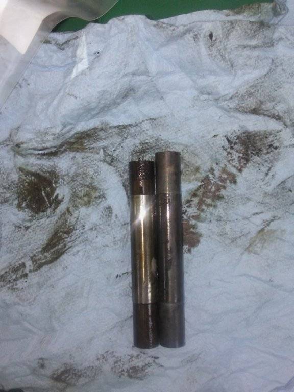

Not a bad idea to check the length of your rod at this time.:lol:
Your fuel pump pushrod that is...
I've been waiting for this fix. I'm with Matt on this one. Kinda ah PITA to swap out but you probably won't live long enough to ware out another one. slather up the new push rod with packing grease before you insert it and bottom it into the hole when you do. (The grease will hold it in position long enough to insert the fuel pump lever underneath it) The pic JCT iz showing US iz enough ware on ah push rod to leave you on the side of the road scratching your head, Happy Trails, Jer
