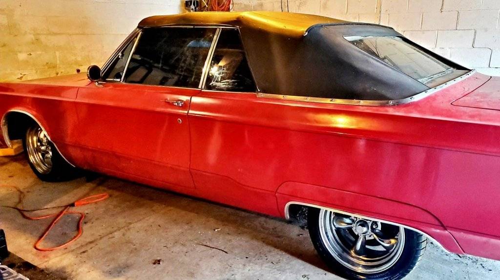

So planning my big boy engine build and need some guidance from the Vets. So i have a stock 440 with original 16k miles and sitting in the garage for years. I currently have an aluminum radiator and Quick Fuel Brawler 750 on the stock intake and dual exhaust with Super 44 Flowmasters. She runs damn good. So I will drive her this year and plan my build. The goal is 500 HP or close to it following the Motortrend build, my question is what other upgrades to the car must I do o be safe and efficient with the added horses. She currently has newly rebuilt 4 wheel drum brakes and I guess stock 300 convertible gearing. I am open to any and all suggestions. How You Can Build a Stout 537HP Street 440

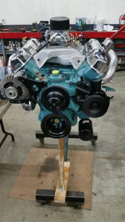

Big drop tops in nice condition are getting rarer by the year and yours looks like it has lots of potential. IMHO I would spend the money you are looking at here, (something like $12 to $15,000) on making yours really nice, and just do a quality rebuild on the existing motor with upgraded pistons, heads, intake, carb, timing chain, oiling system, exhaust etc. It will be fast, reliable, and top down to boot! These are only my thoughts, but having just finished my 67 drop top (well almost!), I like where I am at. I also had the luxury of a group of Mopar fiends and friends who helped me make decisions along the way and avoid costly mistakes. Here is my 440 TNT all done. Moves the big boat along at an impressive rate. Scares the hell out of my wife! All good!

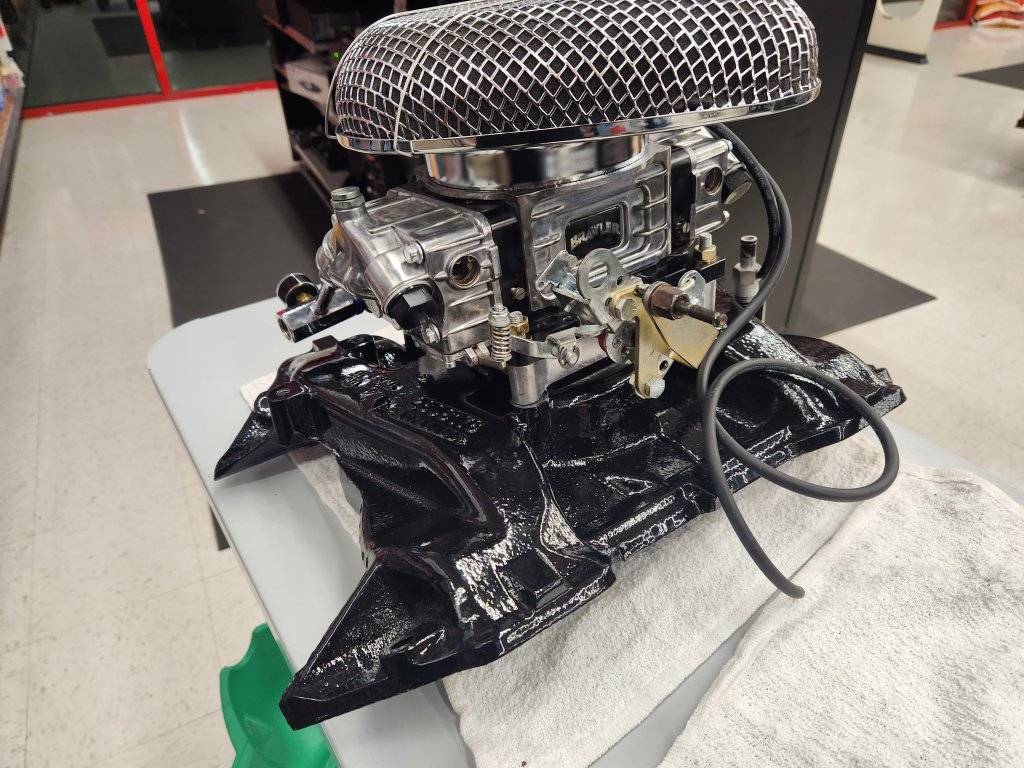

Cortez
Jun 6, 2016
127
70
York, PA
So after a little more research I did confirm that adding massive HP in a vert is different than in a full body..I will take the advice and spruce up under the hood without going full drag race and enjoy a reliable street machine with a bit of sasss. I have an upgraded aluminum radiator and a new carb Brawler 750 and got the stock intake powdercoated, I also rear built the drum brakes from drum to master cylinder lines included. My question is now what additional areas need to be addressed for my lady. The tranny is leaking from the front but I'll do the seals and filter as I think it is from sitting so long. She has 16K original miles but has been garaged for the last 15 years.
