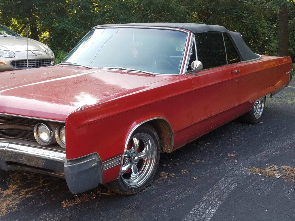

    Hey fells, finally gathered the parts for my upgrades and brakes and shocks are done, exhaust still needs done but I figure take care of everything I can myself first. What is the best order of operation? I have new carb, valve covers, cap and rotor, plugs and wires, starter, alternator, belts and radiator w/hoses. What is the best order to attack also should I do a new intake manifold gasket when I do carb? Thanks guys your knowledge is appreciated.

    Hey! Nice looking red convertible you have there. Please tell us a little more about your car: does it run currently? Does it really need an alternator, a starter and a carburetor? The points, plug wires and distributor cap are probably a good idea, but I'm not sure about the rest of it.

    Well the side pipes are out after some in-depth research and my brothers on here i learned and confirmed the 90 degree turn cost major horsepower and the side exit will fill the car with fumes when the top is down. ( Thanks Charlie from the Carlisle Chrysler Show) So she'll get duals straight back thru 40 series MagnaFlow, I've heard em on a 68 and loved the rumble. Stock carb was abused beyond repair so i got a Quick Fuel 650, she needs a radiator as it is leaking at the seal along the bottom. The starter has started to seem to lose power to crank when the car is hot or has been running a while. The reason I considered swapping the alternator is someone painted it with cheap chrome paint which must have been 15 years ago. She runs but I haven't opened her up yet as the leaks and breaks in the exhaust are horrible. I figured with the length of time she has sat new was best but I like the idea of fixing whats wrong instead of fixing for fixings sake with 16,000 original miles I am sure some seals and gaskets are all thats necessary.
