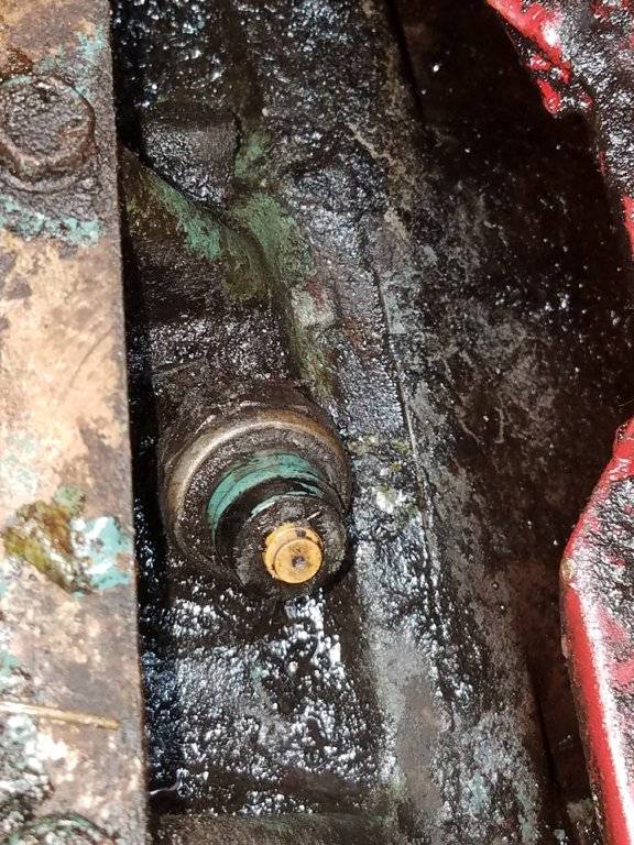

Hey fellas this lil switch is spitting oil it is right back by the firewall and has a simple wire attached to it...thanks a million guys
"Sending units" can be of two types.
"Sensor" is a variable resistance unit for variable voltage to run a gauge. Many have a large, bell-shaped section with the electrical connector at the top.
"Switch" is either "on" or "off", to run an indicator light.
CBODY67
Lol thanks guys...i have one on hold to grab in the morning. .8 bucks to stop an oily geyser...sheesh
Ok, so is that part available aftermarket or is it a OEM item???? :)
OEM type unit. Easily available from aftermarket sources and I'm sure there's some overpriced NOS boxes out there (that may or may not have an actual, never used Mopar part in them) but it wouldn't surprise me if you could still buy it over the counter at your Mopar dealer.
They often start leaking and IMHO, a lot of rear seals have been replaced unnecessarily because of them dribbling oil down around the bellhousing.

Those take a special socket don't they? I seem to remember having to make an extra trip to the parts store.
