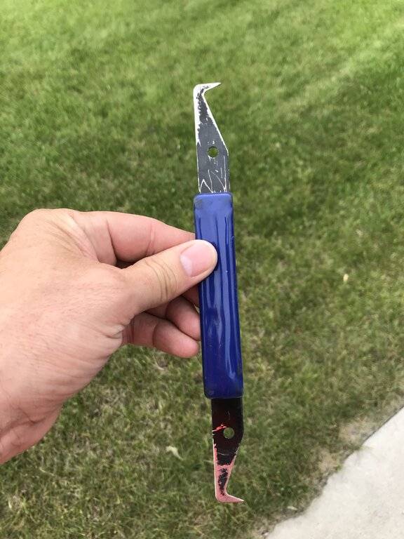

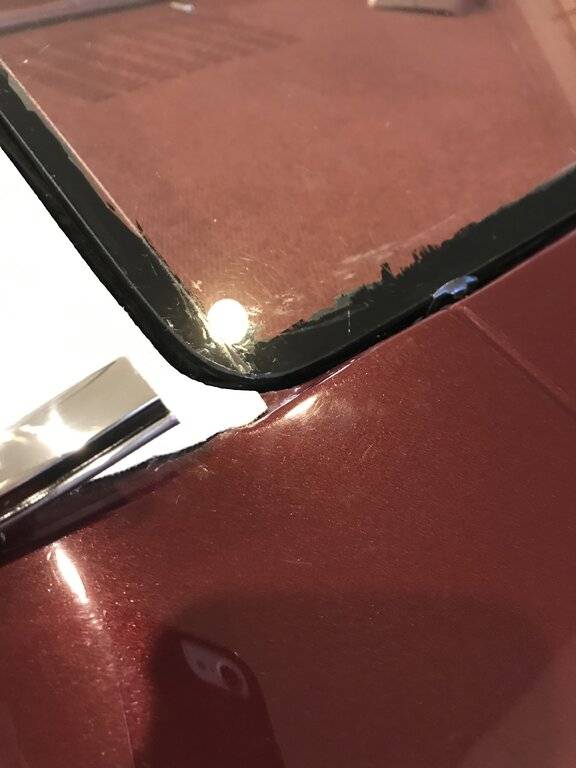

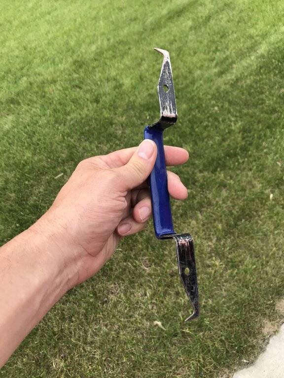

    You are correct technically the side wrap around ones do not need to be removed for the rear window, but if you do it is a bunch of those spring clips with two studs with nuts to be removed from the trunk side.
    the rear bottom trim has vertical clips on the back edge of the window frame. These trap the trim bottom edge.
    A razor blade on the bottom edge between the paint and trim may help loosen that side. And then again on the window side until you feel the back edge of the trim and the clips.
    One of these tools help to release each clip.
    first picture may show the orientation of the clips.

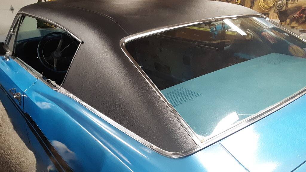

    It looks like you're gonna need to fabricate parts of the window channel as well. I did my own as the old remains of the vinyl top held the moisture in causing it to rust. Oh the fun we have.........:steering:

    Its worth the effort. Mine now looks like this.
