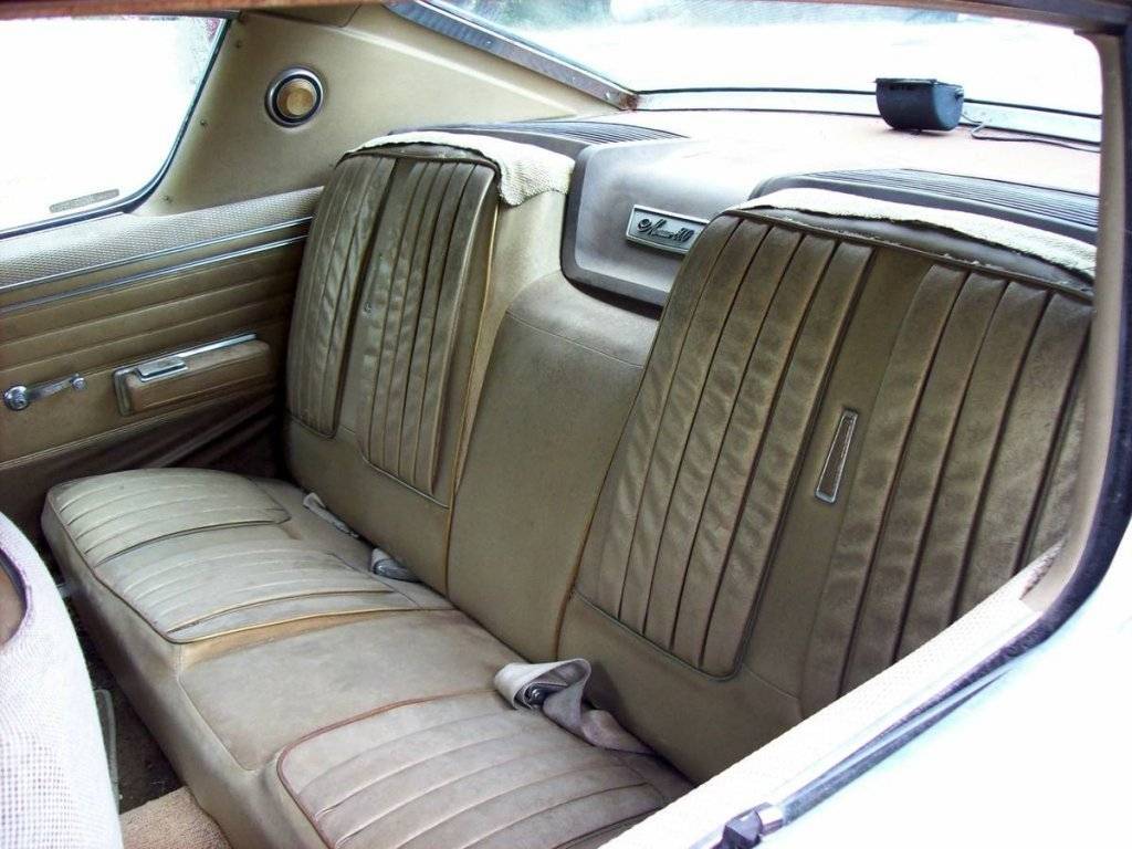

This is a snap of the 68 Polara in the battery disconnect thread. It only has one screw hole. IMHO I think the one screw looks cleaner.

Evidence is stacking up that 67=3 holes and 68 =1 hole.
I'm inclined to say "yup". Not my 68 but A 1968 Monaco, single screw:
