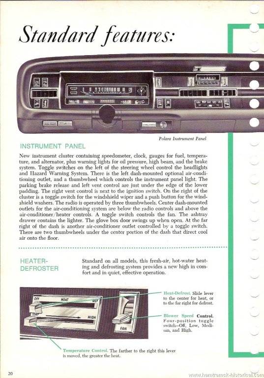

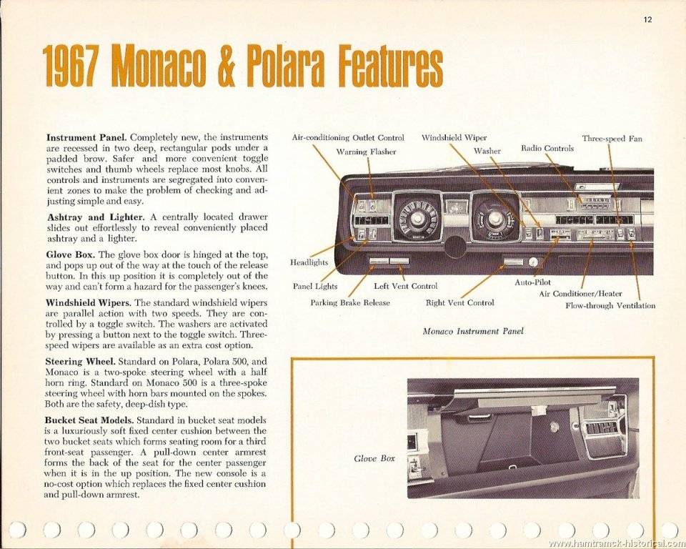

Hi everyone. I am starting to restore my 68 Polara 500 H code convertible and I have an opportunity to buy a 67 or 68 Monaco with a clean dash pad. If I remember correctly, the 67's and 68's were unchanged and interchangeable, but before I buy the car, I want to make sure the pad will fit my 68. Any thoughts?

Thanks CBODY!
From hamtrack-historical
1967
1968
To me, they look different in the pictures, but without seeing them in person I'd still be guessing.
Most of the Chrysler/Plymouth/Dodge cars in 1968 had some form of lower dash pad, looking at those pictures I'd say no the 67 is different than the 68.
Alan
All C body dash pads were changed for 1968 due to new safety regulations that went into effect that year.
Jeff
