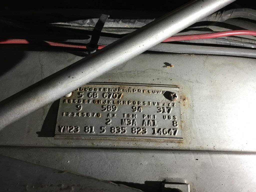

Hello,
I was able to decode the majority of my Fender Tag, but have a couple holes if anyone has a full list somewhere and could help me out?
I'm also wondering if anyone has any good sources on learning how to verify numbers matching car to block, heads, rear end, etc...?
Here's what I have from a decoding site:
5 78 6707
1 91 2589 8 951 316
2 M3A BB1 8
YM23 81 5 835 906 14877
Last 6 of VIN (for Matt!) 108920

You have the silver leather interior and we’re all going to want to see it immediately or sooner.:wideyed:
I’m thinking d-7 is either rear seat speaker w/reverb or heater rear seat with defroster, do you have either of those?
I never figured out e-8, I have it as buffed paint but I don’t know how I came up with that.
No clue on the W-3 either.
Do you have the build sheet for it?
Hey Matt,
No buildsheet... It does have rear speaker and rear defrost...could be onto something!

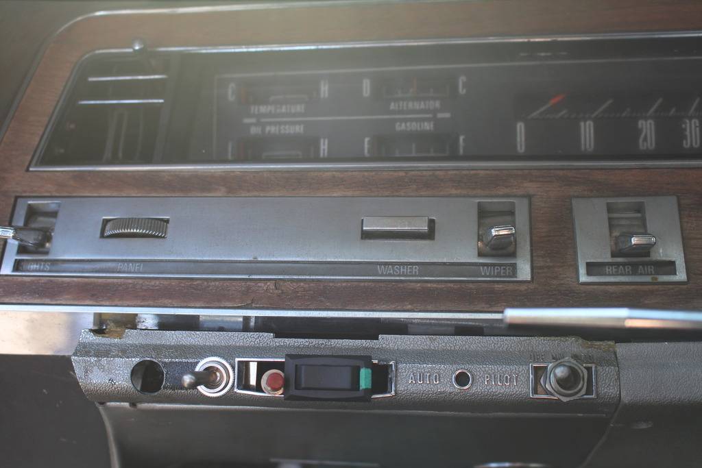

Yes, AC car, and rear AC, but no Auto temp.... why is that a huge question?
Auto temp rarely works and is difficult and expensive to get working.

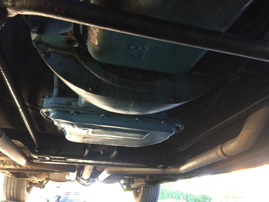

Also want to work on documenting the numbers of the engine, etc...have never really done that kind of thing before, so am researching matching numbers info... I know there's laws about protecting previous owners identities, but I want to look for ways to find out what I can about other owners. My keys are stamped with 'Crane' which seems odd. Previous Owner said he was told from AZ auto broker that it was owned by Bob Crane, but that's all hearsay...
I have the linkage to hook up the AP under the hood, but still need to install it, then test to see if it works.

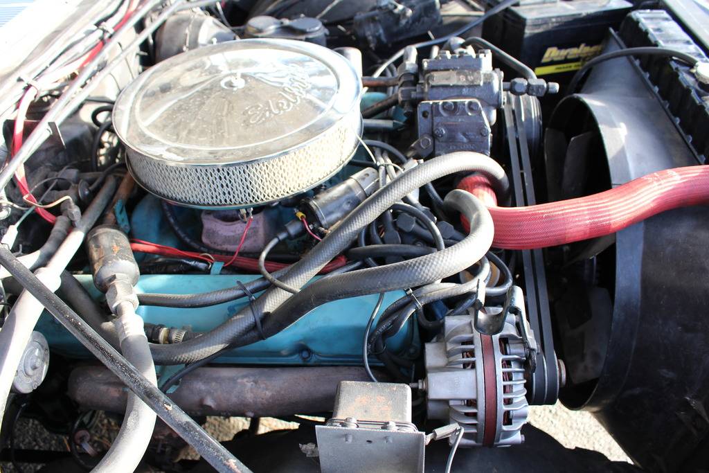

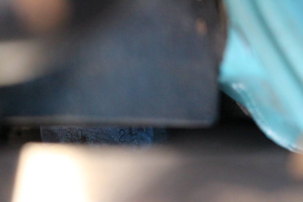

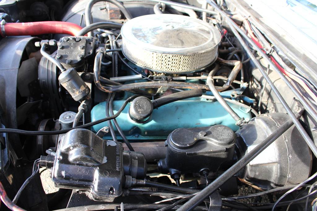

The one pic of the engine shows the casting number on the side of the block, adjacent to or on the other side you’ll find a casting date that’s a bit smaller than the casting number. Our build dates are only 2 weeks apart and you’ll find pics in my Imp thread of the casting date on the engine there for reference.
No rear A.C. in your car. The switch that says rear air on it is for the rear defogger.
