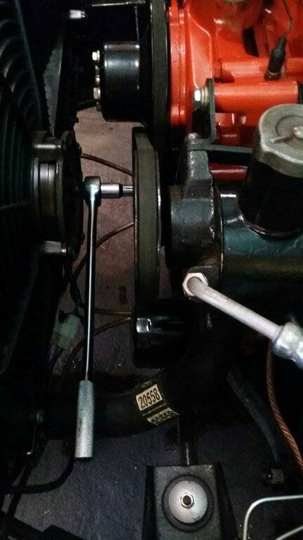

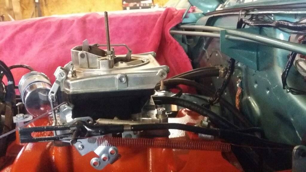

I got an update on our '67 440 stroker Fury. Yesterday we did a crank test where we put a breaker bar on the damper bolt that holds the damper to the crank. We cranked the bolt before we started the engine and let it get hot then we ran the engine until it was warm at operating temperature maybe a little more, then shut the car off then cranked the bolt again. We cranked the bolt 3 times and it turned about the same each time when it was cold and hot. The car ran great as always until it got up to operating temperature then started misfiring or shaking, we let it run and when it got hot the electric fans came on to cool the engine as they were supposed to twice maybe 3 times. I also have this thread posted on Moparts,that being said our Mopar friend/mechanic/guru I beleive saw it there and called my stepfather about the car. My stepfather talked the problems over with him and another friend, and they both say to check the valves because it might be a tight valve guide problem as they were common with 440 source heads. So the next plan of action is to put a 4th distributor in that is built to spec for a 440 Super Commando, then go check the valve guide. Stay tuned. Here are some pictures of what we did yesterday, below is the ballast resistor and the last blurry temperature picture is when it started misfiring and when we shut it off .We started it up after we shut it off 3 times and it started all 3 times with minimal issue.....

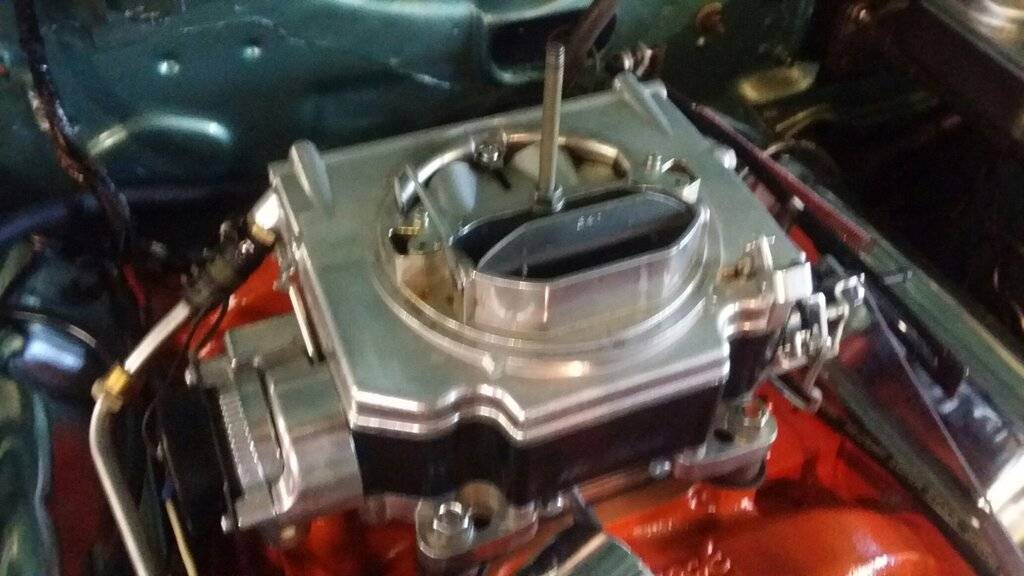

That is a very nice looking carb! Have you been told the story on the trouble we had getting that car out of the garage/barn it was in when your step-dad first bought it? What a nightmare. Locked up wheels, in between support posts, a complete nightmare.

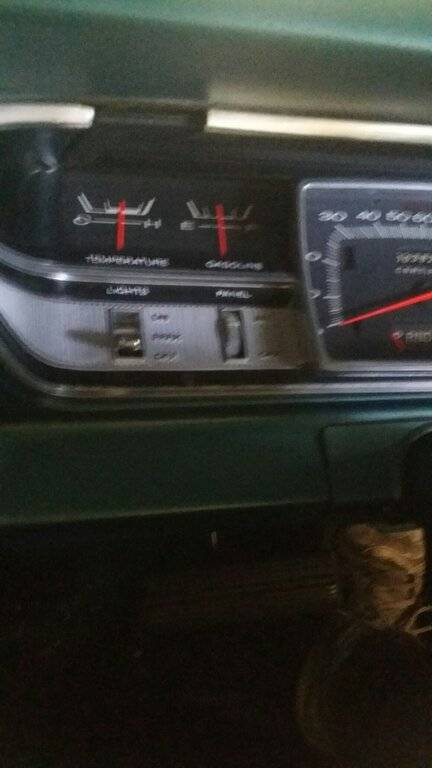

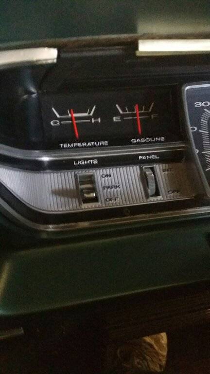

by that gauge, it looks hot. no doubt you've checked the actual temp when the misfire occurs. use an infrared gun on the header tubes or along the sides of the block to measure temperature differences? or on the radiator core to check for cold spots?

The needle in the middle of the operating range is not an indicator anything is too hot.
if all they have is the gauge as an indicator, then they need to do a bit better. what's shown looks hot and should be confirmed.
by their post, misfire does not occur at temp A, but does occur at temp B. putting numbers to this might help.
