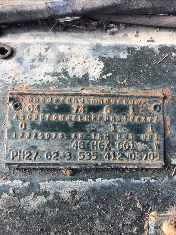

    015DEBBC-46BE-420E-A968-A21350AF7565.jpeg i may have a chance to buy a 67 fury 383 4 barrel 4spd convertible car.
    67 convertible fury lll, looks like 4523 were made.
    I’m trying to find out how many were 383 4 barrel 4 spd cars.
    The car is in horrible condition but would try and save it if it’s real rare.

    You would expect this combo in a sport-fury………….?!

    I agree, I posted a picture of the fender tag. I haven’t got it fully decoded.
    Looking over my notes now, yes
    PH27, H means sport Fury. I’m still trying to find out just how rare this car is. I hate seeing any old iron go to the crusher.

    Hey detmatt!
    Yes, it has a 3:23 sure grip.
    It’s been out in the weather, the top is gone.
    Option tag shows center console 4 on the floor.
    Dark green metallic and a white stripe.
    The stripe is gone.

    a6: Console
    b4: Bucket Seats
    h7: Fender or Hood Mounted Turn Signal Indicators
    j4: Molding - Body Sill Narrow
    p6: Mirror-outside LH remote
    u1: Sold Car

    Thanks
    I didn’t have the p6 figured out
    I don’t have the B-0 or Y-1 figured out

    Y-1 is black top.

    AX48 3:23 sure grip

    The only thing I’m missing now is
    B-0
    And
    TRM, I got R-6 premium vinyl seats
    M-X black interior
    But don’t have T-H?

    T=trim grade and the H=High.

    I’m not sure that any other axles were available in the 67 fury and being that this is a 383 four-speed I’m positive it would’ve been none other.

    412 April 12th

    Well I got the tag decoded on everything but the
    B-0
    You’ve all been a big help
