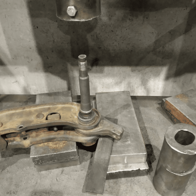

Fun with a 20 tonne press:
I tried to use a piece of galvanised pipe, but the widest size bunnings sells is 25mm - this is too narrow to fit around the pivot shaft once that's been pressed into the bushing, so don't bother going there. They do sell 30mm pieces, but they're at least a metre long and unless you want it for other purposes and happy to cut it up, don't bother. I was VERY lucky that near the press were some very chonky sleeves that barely covered the bushing flanges.

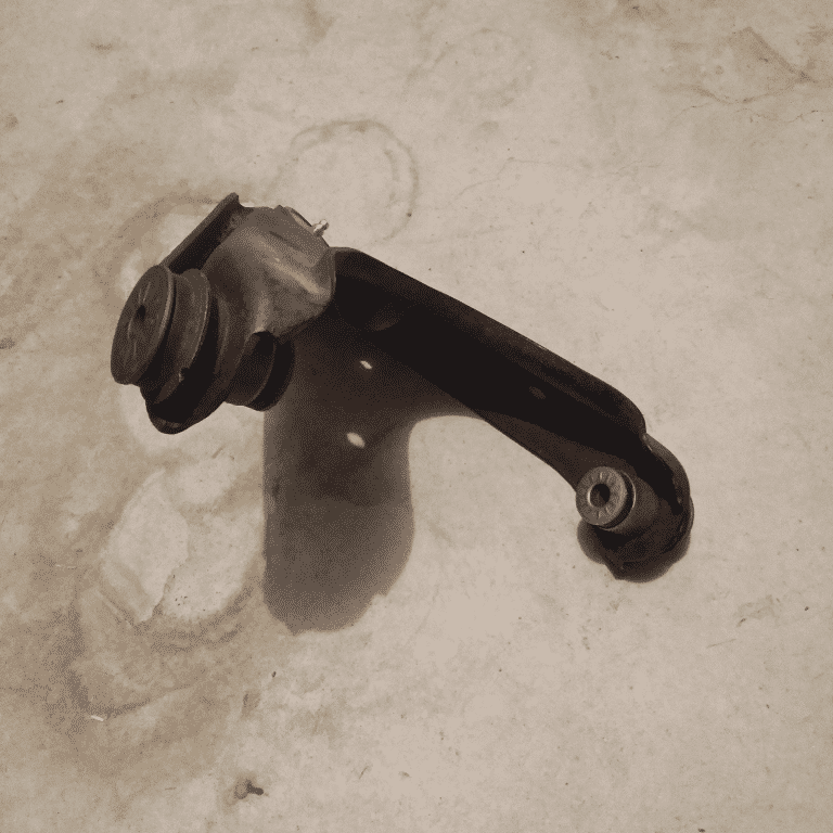

Upper bushings replaced! Press and puller kit made short work of them. Actually kinda fun pressing them in and out. When pressing them out I had to use a stack of washers to make sure the sleeve wasn't lopsided.
