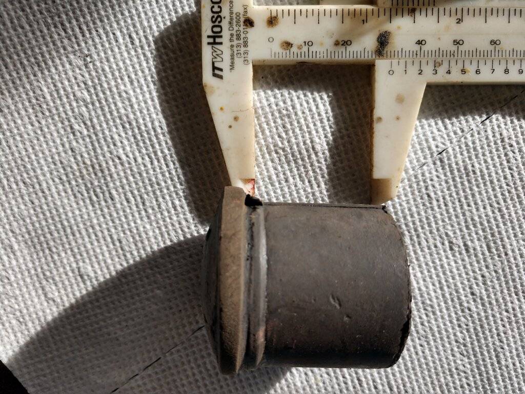

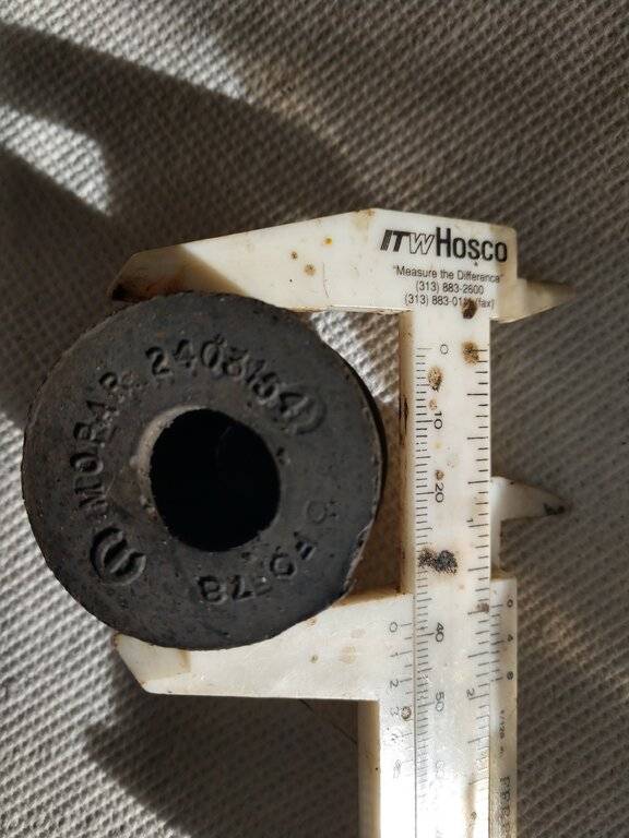

    Any one have a source or work around for shackle bushings on a '67 Imperial? it uses #2403154 shackle bushings which are 1 1/2" dia x ~1 1/4" wide". So far all I can find are smaller diameter bushings. Searched the old threads but didn't see anyone asking this question......
    on. IMG_20201028_163509111_HDR.jpg IMG_20201028_163530831_HDR.jpg IMG_20201028_163554162.jpg

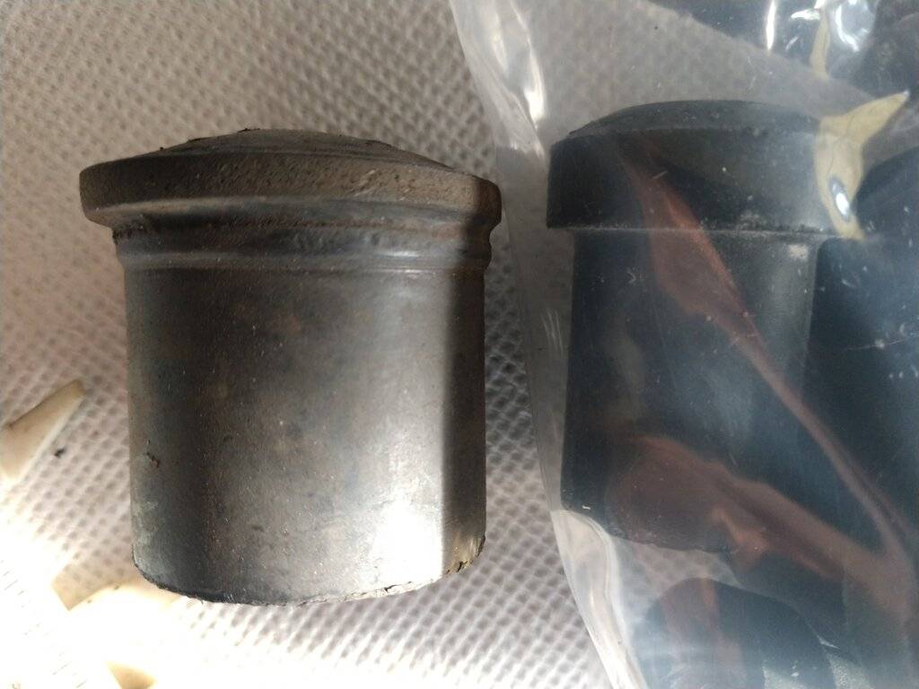

    These are the smaller 1" bushing in the pictures.....I just received them from National Moparts today. So far the AC Delco shackle kit from Rock Auto and the Rare Parts Shackle from NAPA all have the 1" bushing rather than the 1 1/2" that's on the car.
    I'm on the hunt for NOS 2403145 bushings I guess!

    I got mine from ESPO Springs & Things.
    Ask for Laura, they were the same as a Dodge van. The ones they had as listed were wrong. I say she would remember my order as we went back and forth for a while. Tell her you are after the same bushes that you sent to Peter from Australia with the 71 Imperial. Your 2403154 is the same as my 71.
