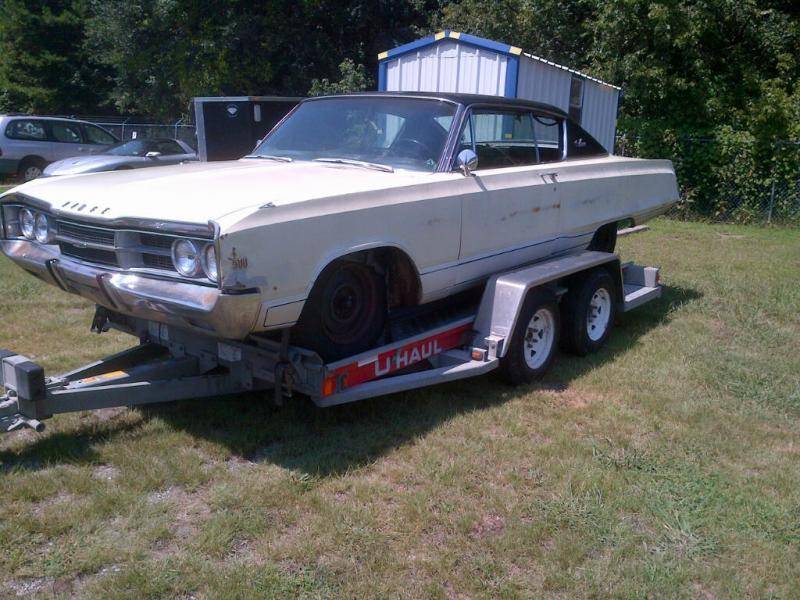

If this works right a picture of the car the day we pulled it out of the woods and power washed it will show up.
Sounds interesting, can't wait to see it.
