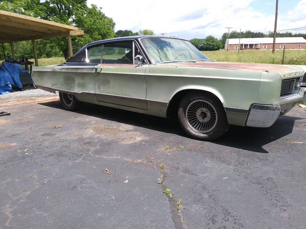

    I just put on some 8" wide turbine wheels and they currently have 245/60-15 BFG Radial T/A tires on them. They are older tires and should be replaced. I'm looking for recommendations on brand. I want white lettering and something that will last a decent length of time given that it wont have a huge number of miles put on it. I do not want the same tires. I'm not paying Cokers prices. I want to stick with either 245/60-15 or 235/70-15 which has a better selection.

    I'm sorry...I made a mistake. They are goodyear eagle gt.

    I'm pretty sure you're going to want to go with the taller of the two tire sizes that you mentioned. Mind are two short so my speedo is way off. I won't make that mistake again. I've heard alot of folks say that regardless of the thread you really don't want to run the tires more than 7 or 8 years. I'm currently running Cooper tires and while I don't have anything bad to say about them I really don't have anything good to say either. I think I have about 7k on them in 5 years. Yes, I know I should be driving it more.
