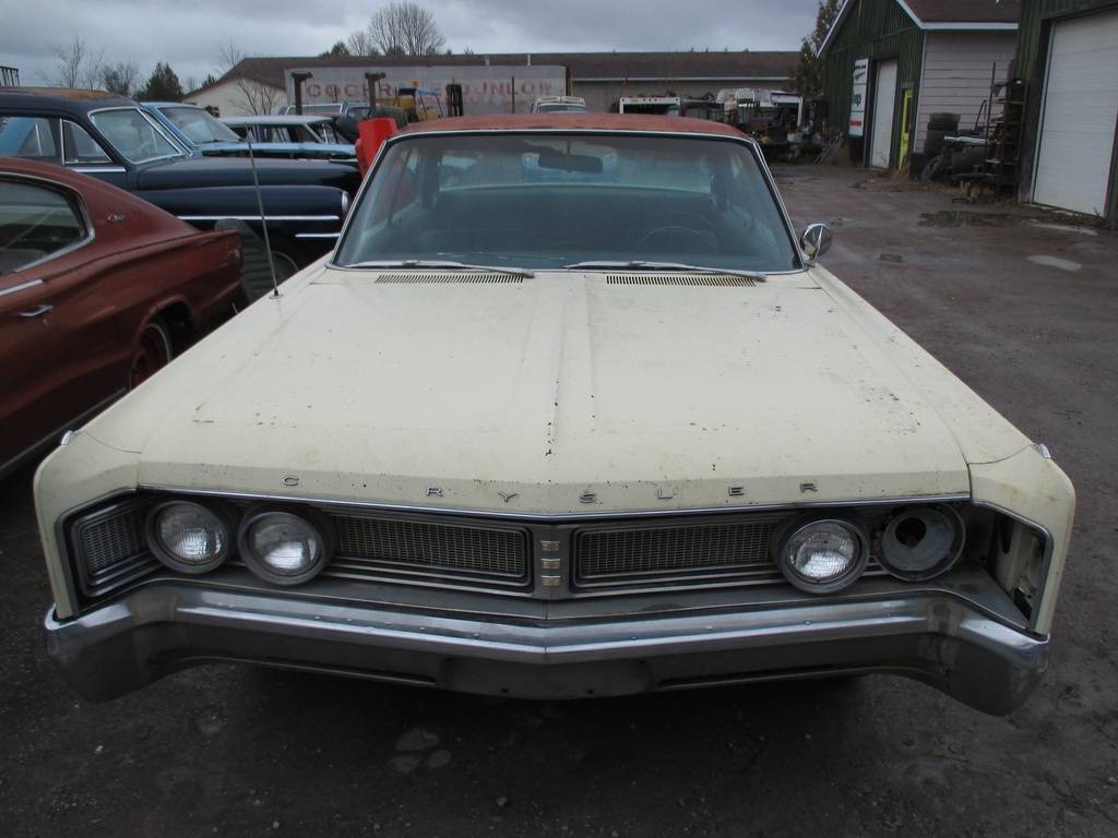

    67 Newport 4 Door Hardtop

    Thanks for the information, The "Custom" trim has different moldings than the car pictured but I will contact him. Fingers crossed
