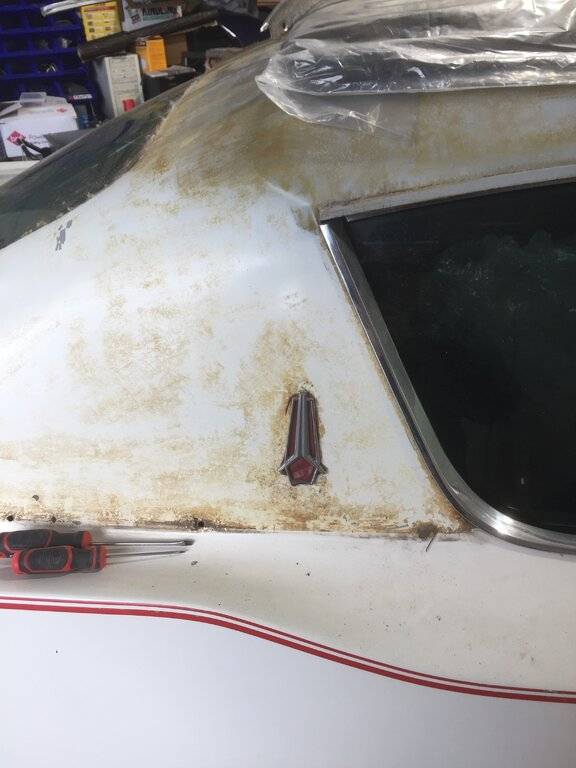

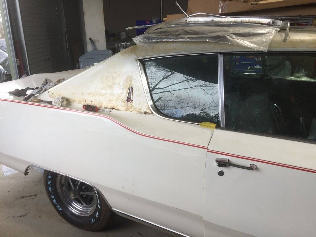

Hi all can someone let me know if the Plymouth badge pictured pops off or do I need to remove inner panel, and everything else to get to it. I’ve tried popping it off and really think I going to break it. Thanks
99% that bolts on. They didn’t do many pop off emblems in the 60’s.
You have to remove the sail panel on the inside to access the nut(s) that hold the badge to the C pillar. You will have to do that anyway to replace the clips that hold the belt line chrome trim to the car.

Correct, & be very careful not to break off the tabs

Thanks for the advice Mrfury will do
