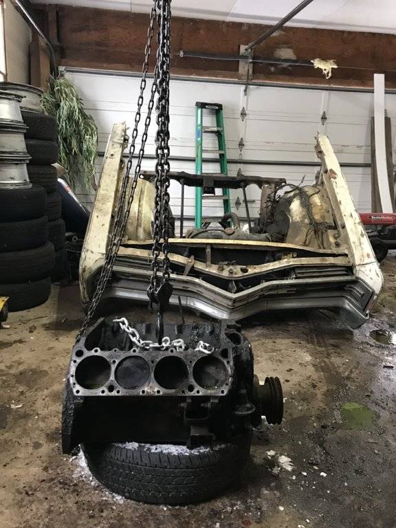

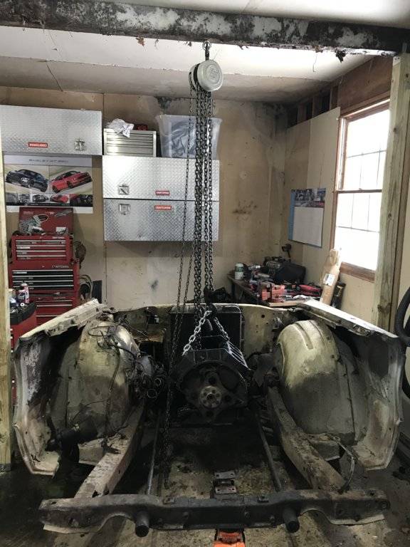

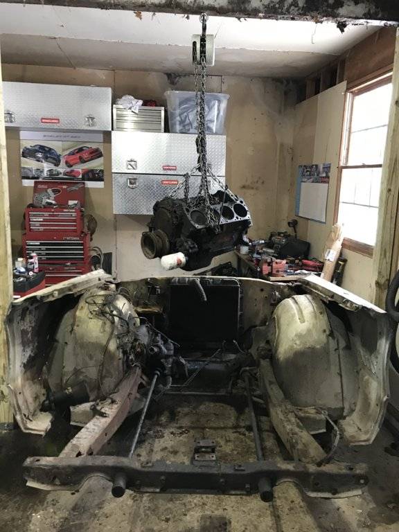

    Thought that I might document my 440 build. Took a different tack to start.
    1. Removed the front clip
    2. Tore down most of the engine as it sat in the stub frame (this was nice, as I could stand inside the frame and work. It provided a nice heavy base to really put some muscle to some of the bolts).
    3. I built an inside beam hoist years ago to help remove inboard engines from boats, as a cherry picker was not long or tall enough. So, I rolled the front clip under, lifted the engine out, and then rolled the clip back. Pretty easy.
    4. Trans is off to the rebuilder
    5. Engine will go next, to what I have to work with.

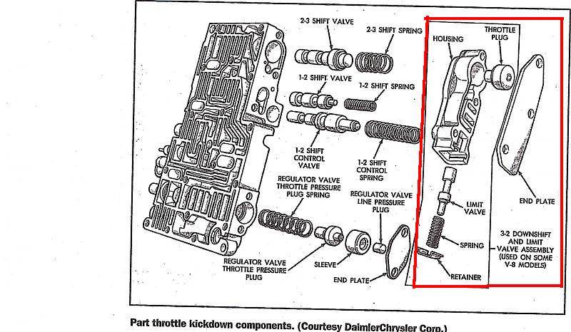

    With your cam selection,for optimum performance in a heavy car I would suggest one step up from stock convertor (2250/2500 stall) and 3.23 or 2.94 gears with the 26.6 tires.
    If you stick with the 2.76 gears,I would recommend adding the part throttle 3-2 kickdown feature into the valve body for better street driving.
    My reason behind the recommendations is to take full advantage of the gobs of torque she will make.

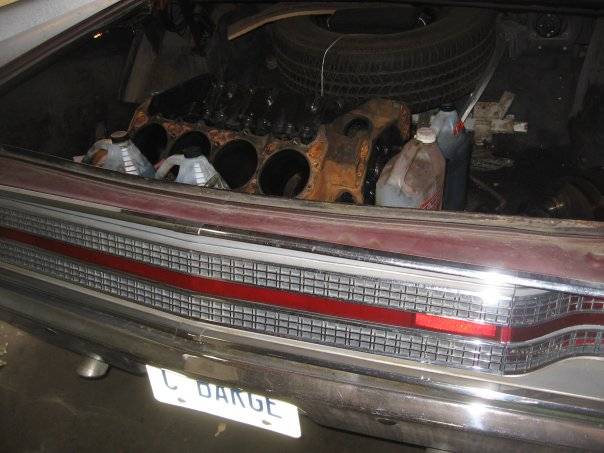

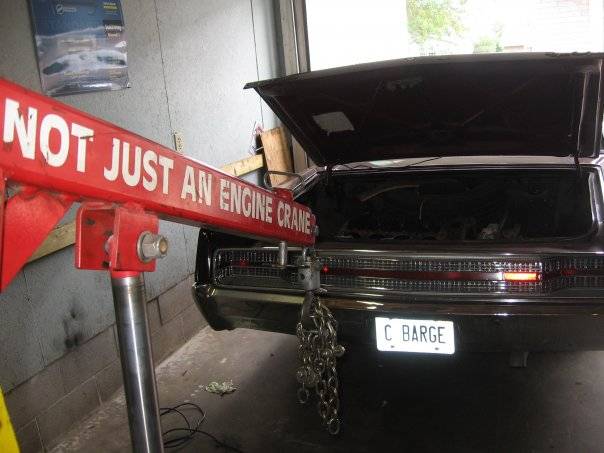

    Remember,before I started the BoaB I rebuilt my 68 440 NYer.
    Interesting how you took apart the car for the engine removal,LOL
    This is what i did on the other end!!!!
    [​IMG]
    [​IMG]

    yea, the 2.76 is the one stickler. I am going to try and see how it goes. I figure the gears will be easy to replace later if I have to.
    The trans is in the shop now. What is this kick down feature? I have not heard about it.

    If the trans is original to the car it will not kickdown when under light load and engine will lug up moderate hills where you have to manually shift to second.
    When you hammer the gas,it will kickdown to first hard then quickly upshift from there.
    First featured in 904/727 behind /6's and 318's in late 60's and later in the mid 70's for big blocks.
    inside the valve body there is an additional check valve the will kickdown from 3 to 2 under light load up a hill slow speed,or when you mash the pedal to pass a truck at hughway speed. no need to manually downshift. It helps with fuel economy and also uses the powerband of the engine more efficiently. .
    Any 70's 904 or 727 has this and can be added to your trans.
    So ask your tranny guy to add that to your trans..you will be happy that you did.

    Also known as PTK: Partial Throttle Kickdown.

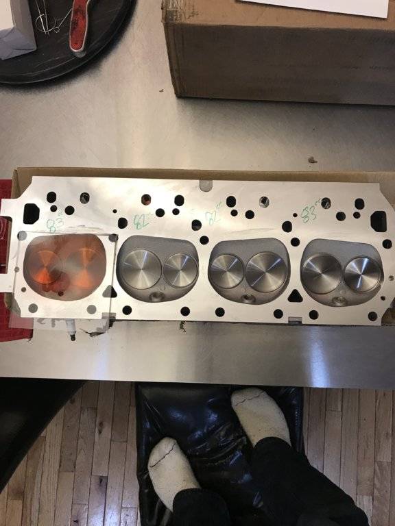

    Starting to put things together. Most parts are delivered.
    Now that I know where my pistons ended up - zero deck as I wanted, I checked the chamber volume of the 440 Source heads, so that I can predict my compression ratio.
    If anyone ever wondered, their site says the chambers are "around 80 cc". I just measured and mine are between 82 cc and 83 cc. Not bad consistency for Chinese heads.
