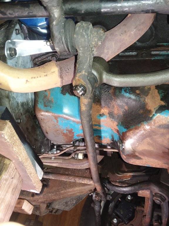

Hey guys and gals I need a little info on replacing oil pump on 1968 Plymouth fury iii 318 what all do I need to do and take off suspension wise or not etc do I need a cherry picker or jack any info would be great

You'll need to drop the center link and oil pan. But how are you going to do that if you don't have a jack?

But: if you remove center link, y-pipe if single exhaust, and remove oil pan, oil pump is can be replaced.
On 1972 Fury 360 SB, I used cherry picker at front of engine and unbolted engine mounts at subframe to remove oil pan.

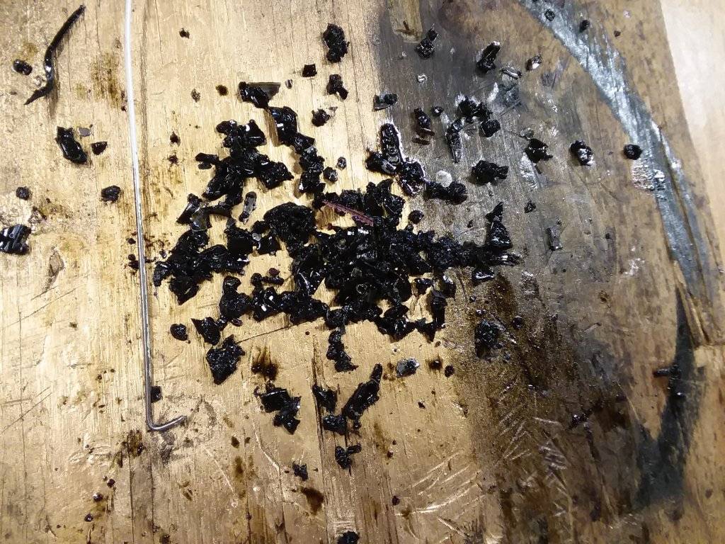

I found the effort was worth it just to get all the junk out of the pickup
If your oil pressure is low or you found broken pieces of valve seals when you replaced the valve cover gasket, the job may be worth doing.
If you found that there were teeth missing from the timing sprocket, or other things that may be possibly plugging the screen, or leaking main seal or pan gasket, I’d say go right ahead and do it. BUT, if there aren’t any significant leaks, none of the other things are an issue, and it runs good with good oil pressure, there’s no need to change the pump. Oil pumps aren’t like electric fuel pumps, they don’t need replacement for piece of mind. I’d be willing to bet an oil pump could outlast a couple 3 engines
