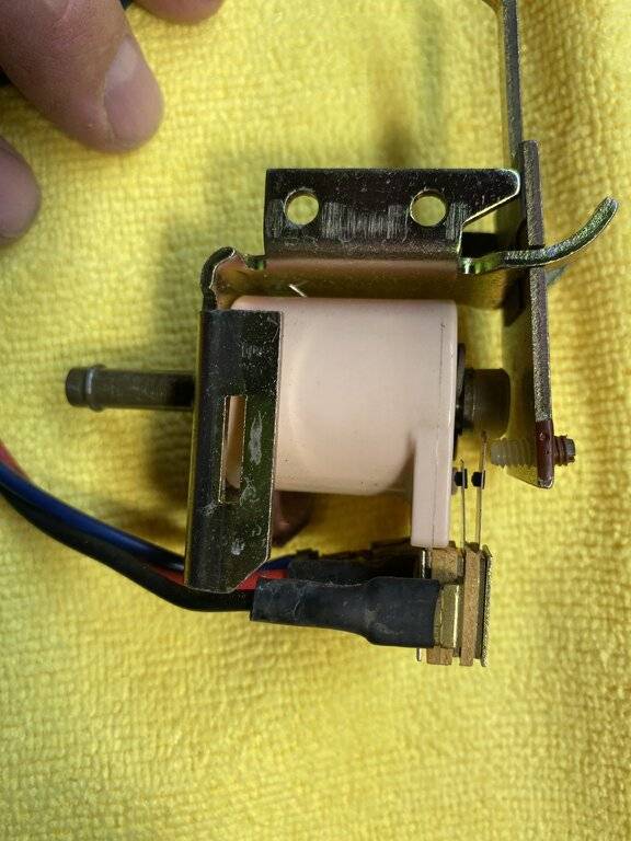

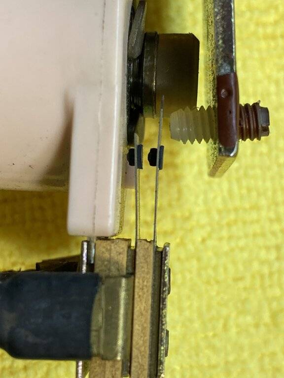

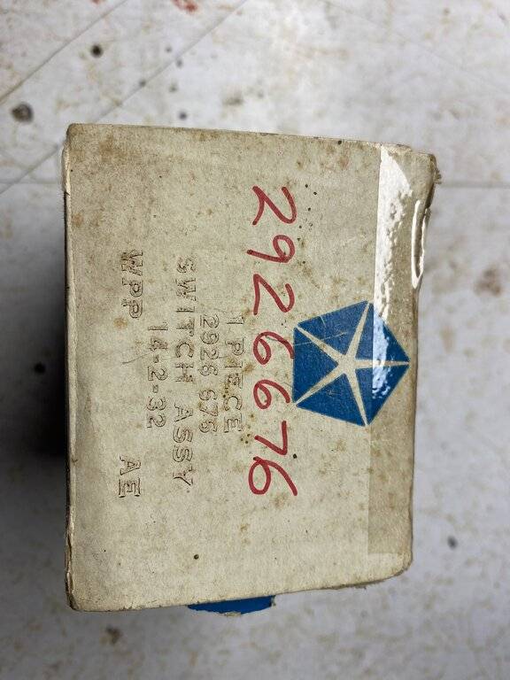

I have NOS switch still in it’s original box . PN 2926676 . It still has its plastic Guard . I bought it a while back when I was troubleshooting a issue on my 69 sport Fury’s C/C . The 68/69 C/C are the same.
Welder guy
Dec 30, 2016
10,302
14,795
Millet Alberta

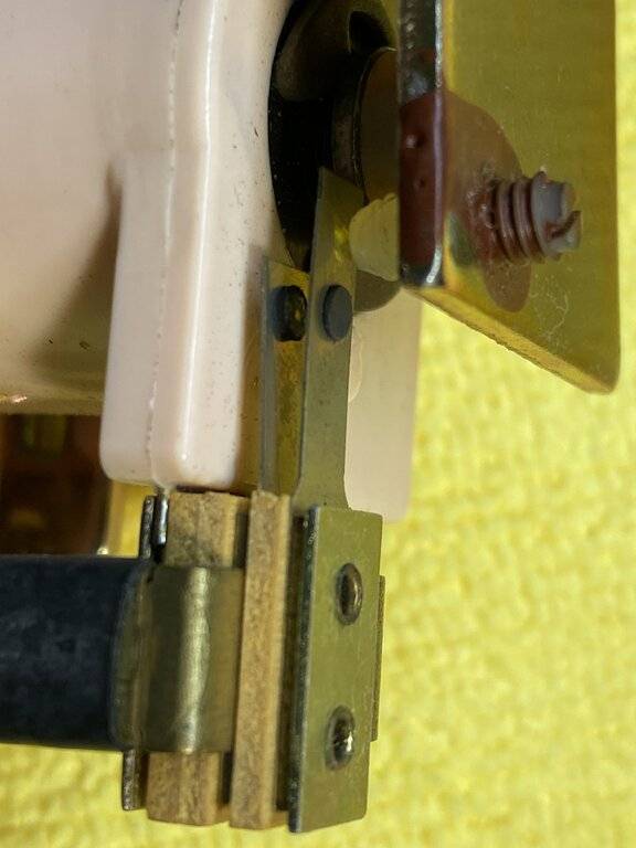

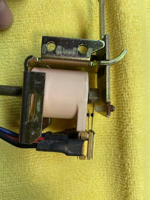

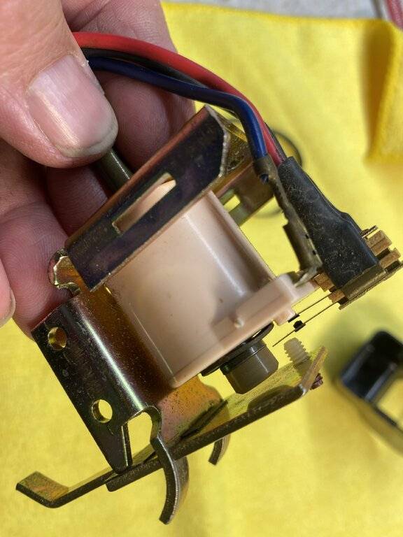

Here’s a few pictures of a used one with the mounting bracket on it . You will need the bracket to properly mount the switch beside your brake pedal . This switch is missing the brake pedal switch arm that you can see on the new switch

I think what you are suggesting is that both are needed to work as the unit? If that’s the case, what you need for both pieces?

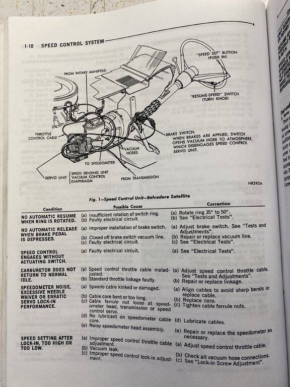

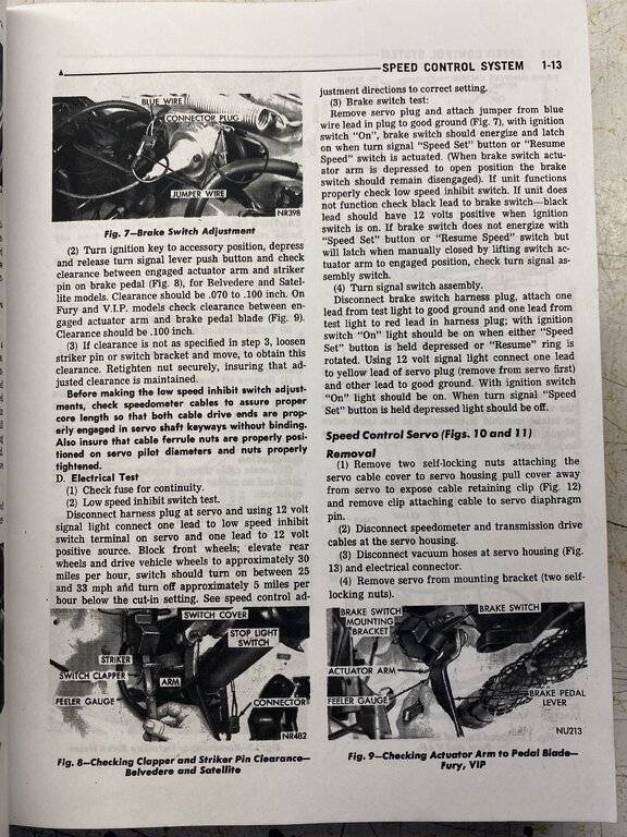

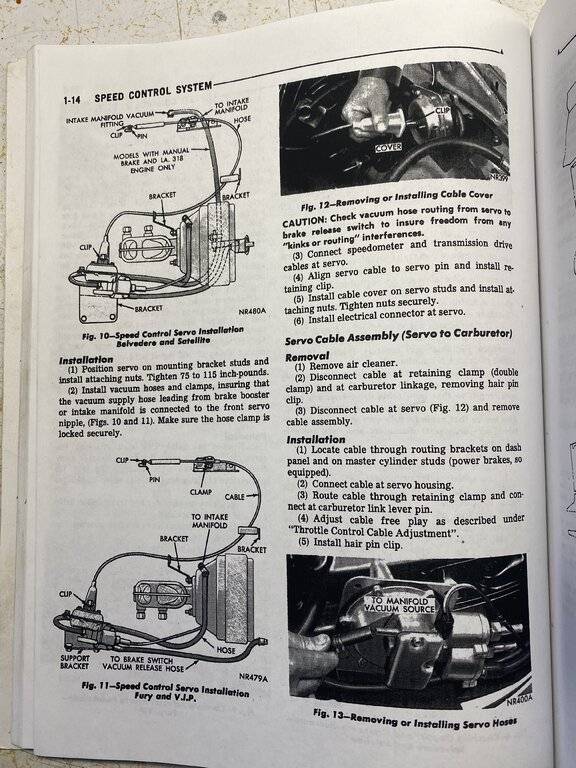

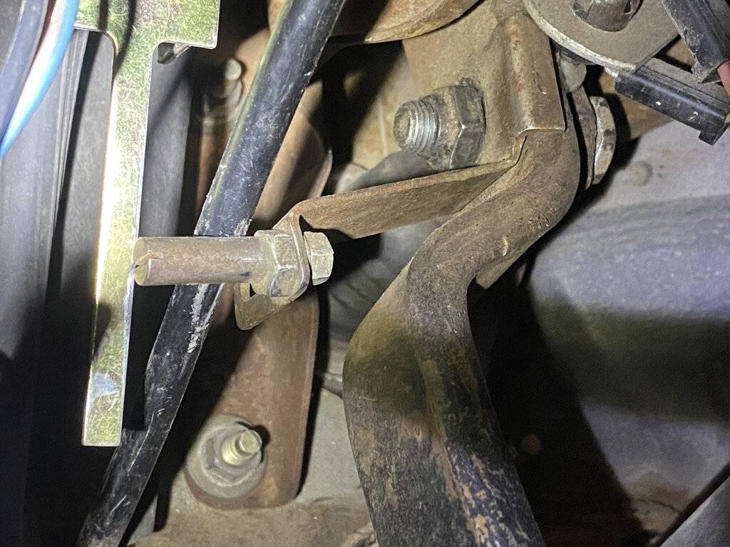

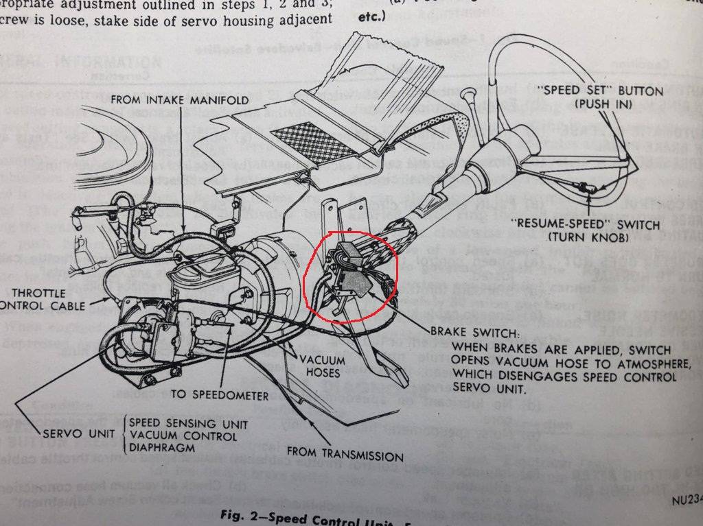

Yes , you need the switch, mounting bracket and the striker pin ( for lack of a better name) that mounts on the brake pedal, it’s the part that touches the switch arm when you press on the pedal. The shop manual for your car is your best friend in this case it has detailed pictures of what parts you need and how to make them work.

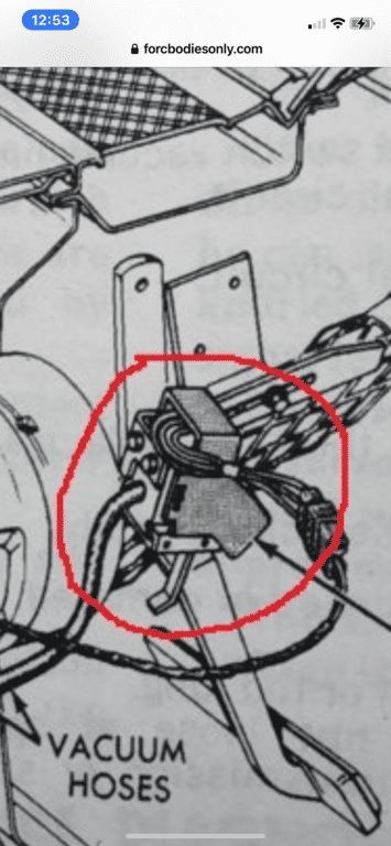

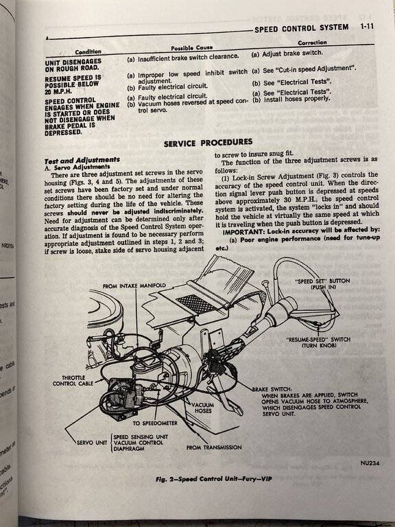

Yes, I have the service manual however could not see that switch clear enough. My internet search gave me part #2880115 and now I can't find the other, seems it was from B-Bodies forum but didnt look like it had the vacuum switch. Anyway yours looks like the correct one.

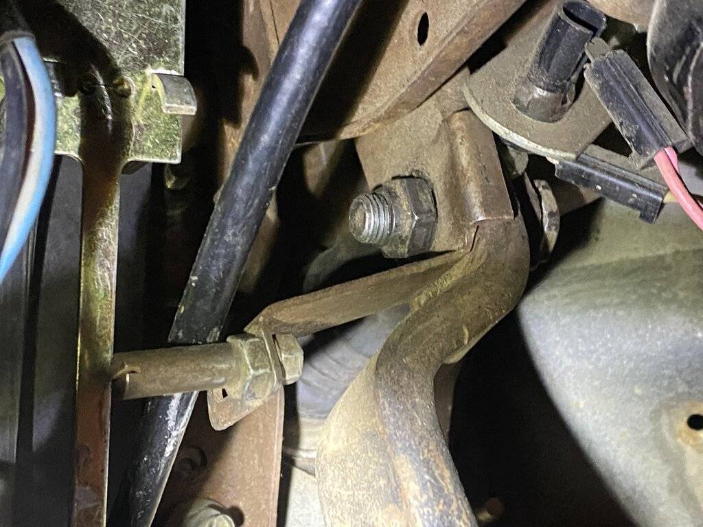

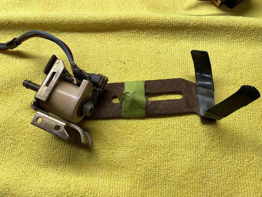

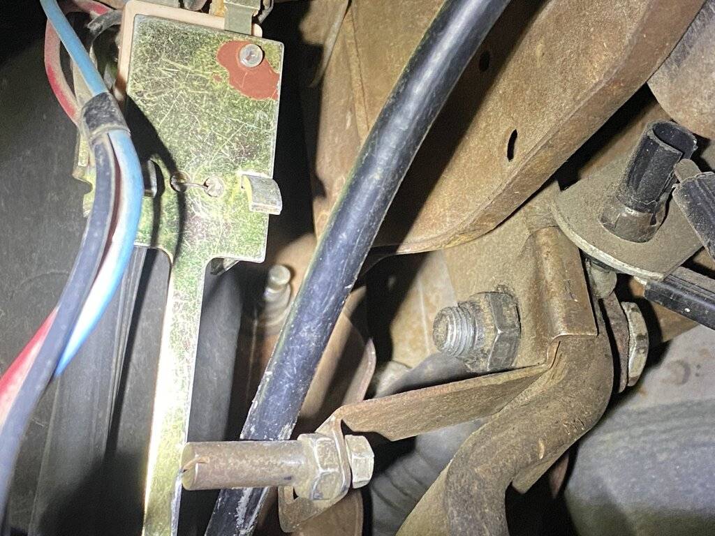

Here’s some pictures of the C/C brake switch and the brake pedal striker . Sorry about the crappy pictures but it is an extremely tight fit getting in there , I highly recommend when you do the install of the cruise control you take the front seat out , it will give you a lot of room to get in under there .

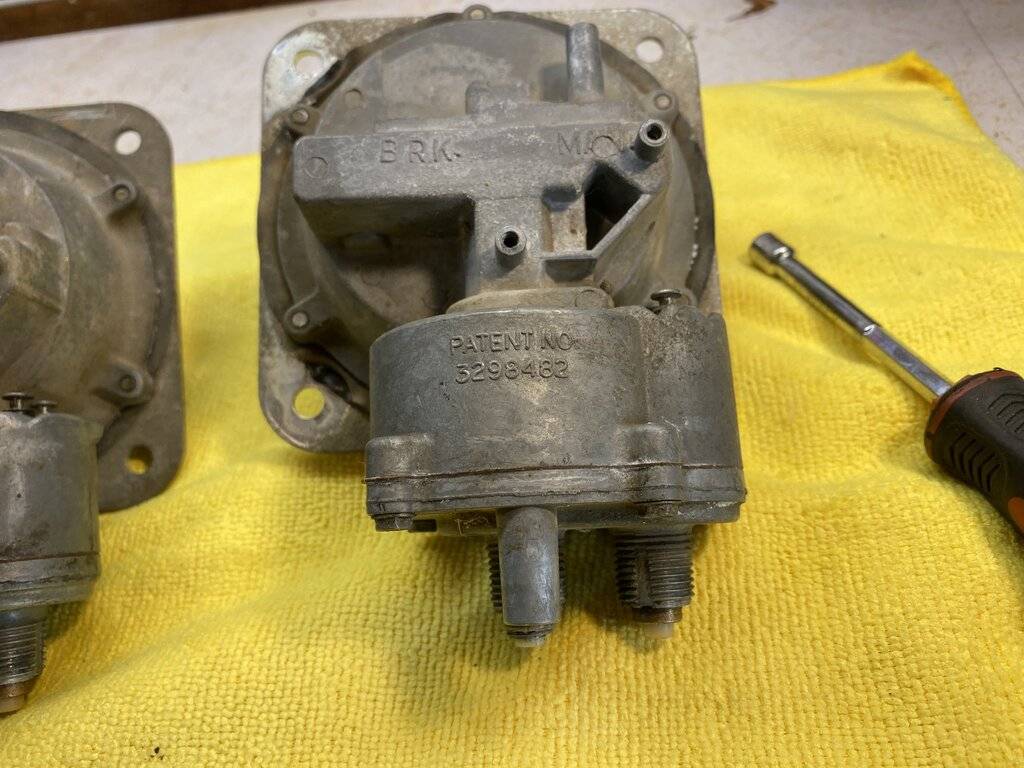

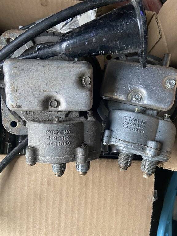

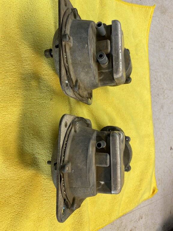

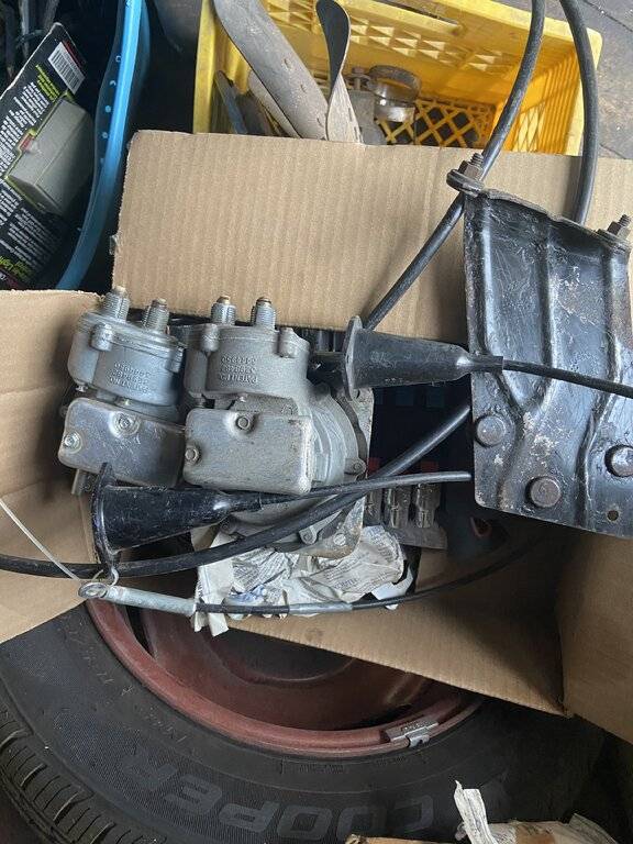

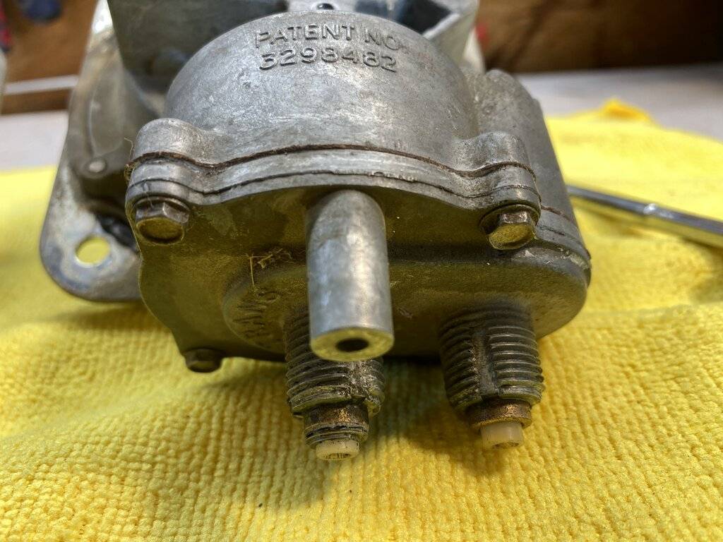

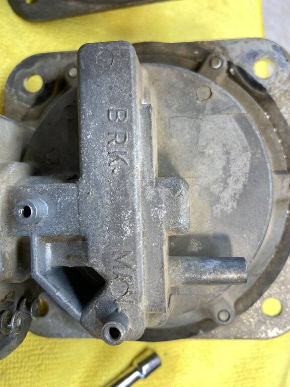

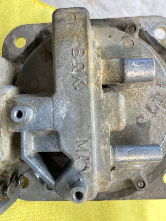

Hers a few pictures of the servos for the 68/69 C/C . They both work the same and look alike with one difference the vacuum line that goes to the brake switch is on the back of the servo beside the speedo cable connections while the other servo’ vacuum connections are on the front beside each other. All mounting bolts and wiring connectors are identical and work the same . I have taken the servo mechanisms apart cleaned , lubed the gears and replaced the small filter . It sure settled down my bouncing speedometer needle .

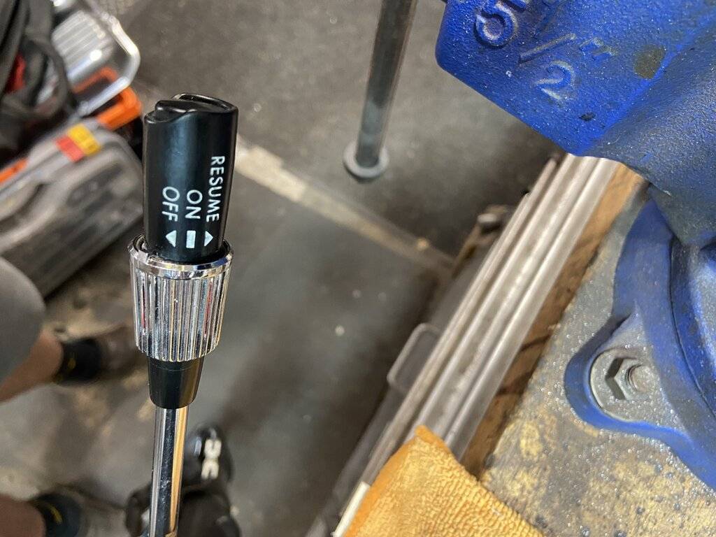

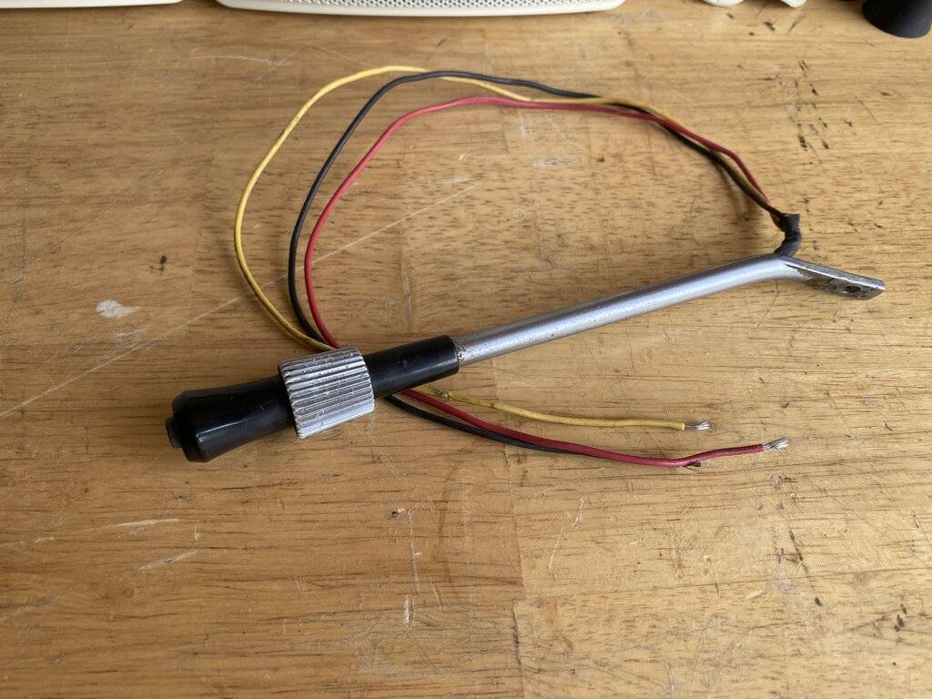

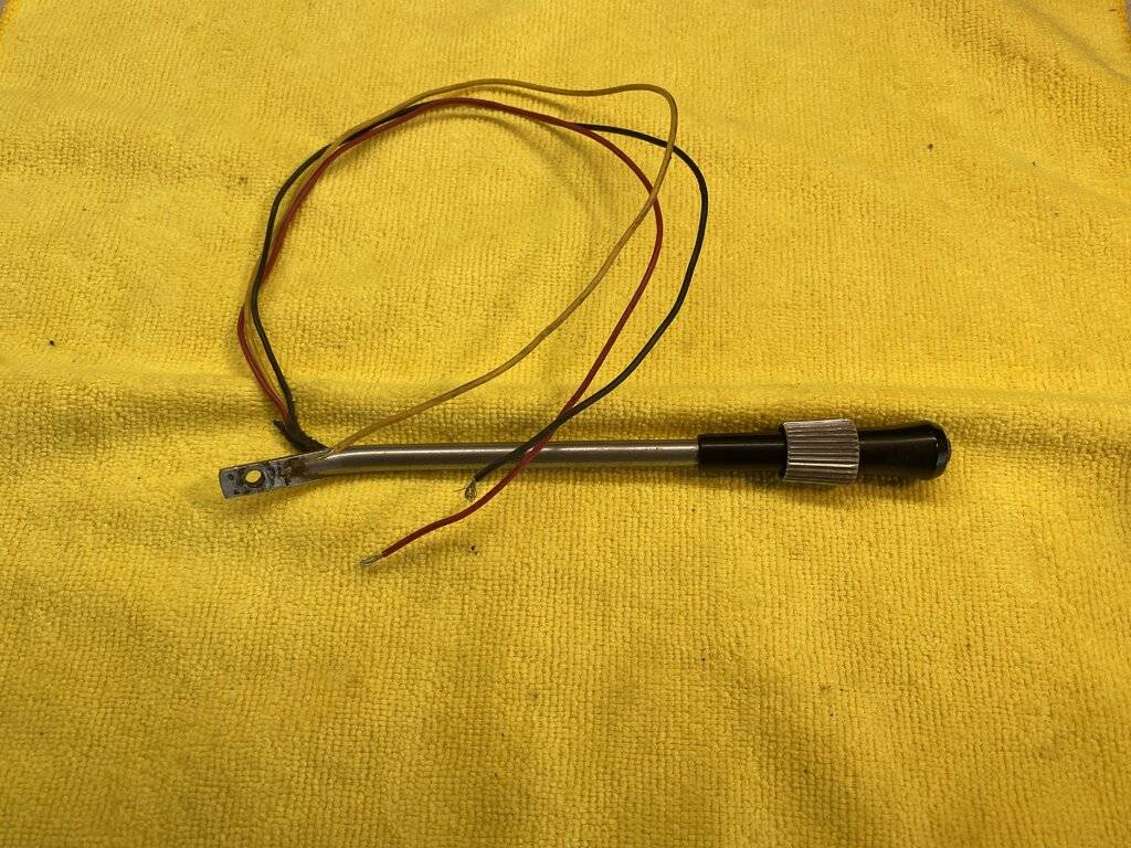

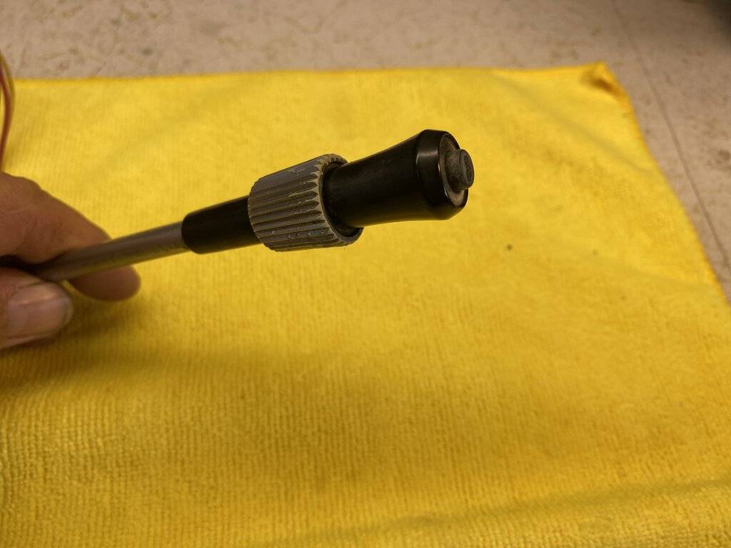

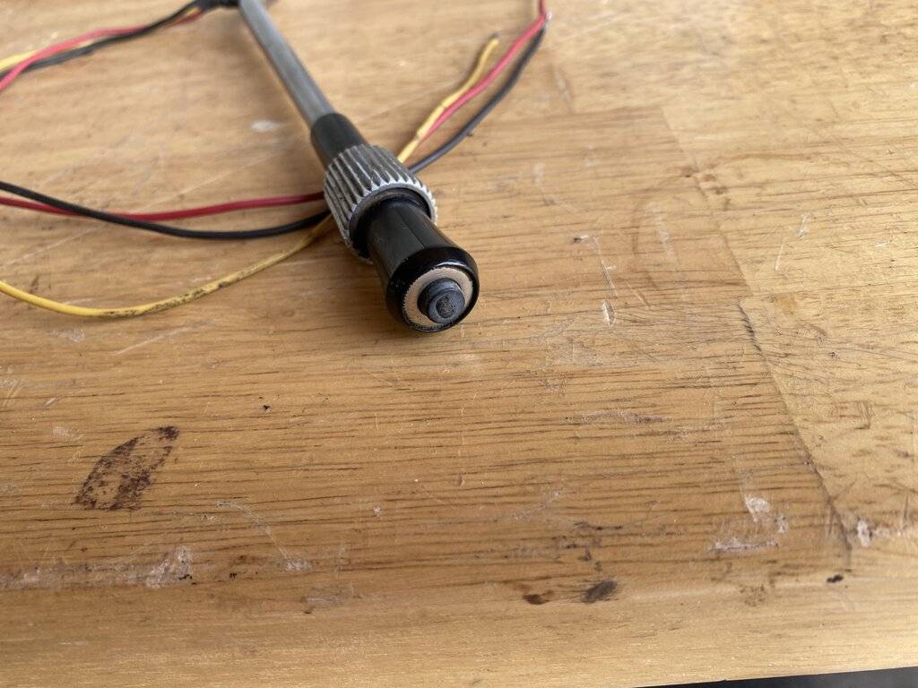

These servo’s work with this 3 wire style of Signal light handle with a small button to set speed on the end and chrome twist ring for resume

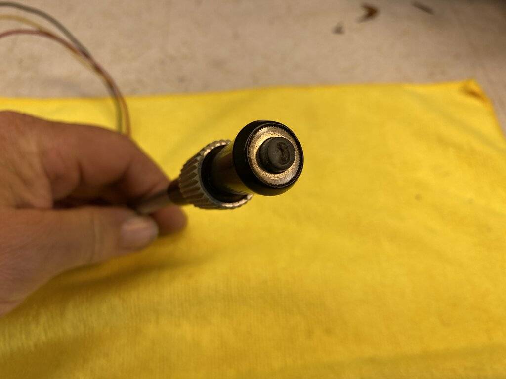

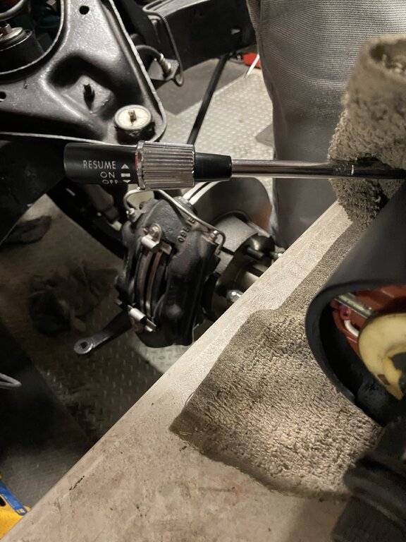

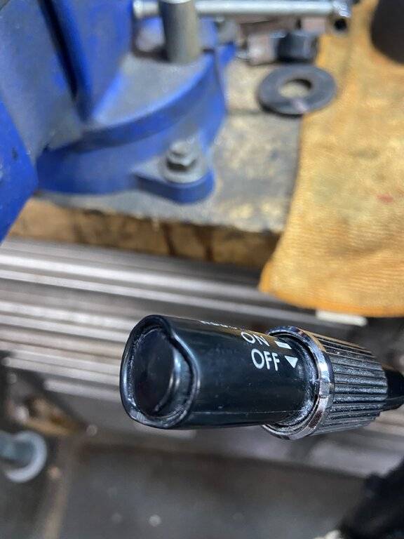

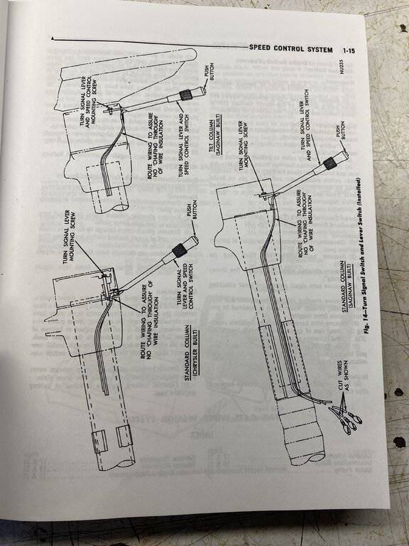

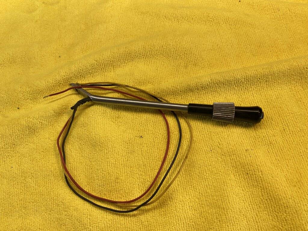

Ok, I didn’t see this message before I sent the last one. Here’s the pics I have. I think we are on same page with servos. My cruise lever is a bit different however thinking would function same and require the two vacuum servo.
Welder guy
Dec 30, 2016
10,302
14,795
Millet Alberta

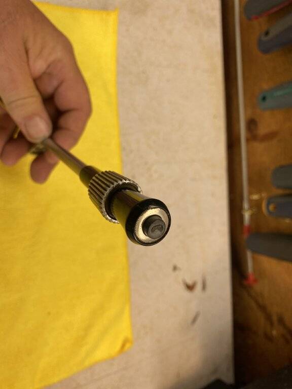

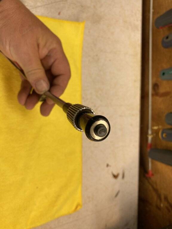

That’s not a 69 handle , that’s a 70 or 71 c/c handle . I will need to see more detailed pictures of the button end and of the wires coming out of the other end . I believe That one works with the newer style servo , the single vacuum port Unidentified Cruise Control Lever.

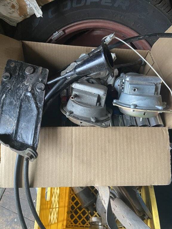

Can you take detailed Inventory pictures of your cruise parts, then we can figure out what year specific c/c parts you have . Then we can figure out parts you need or don’t need. After that we can do some basic testing as per the FSM , then installation.

There was a link to the various years mopar cruise levers in one of your earlier posts. Very interesting. I know I was mistaken on much of them. According to the pictures, the lever I have is from a 72’. I have a 73’ Imperial am sure it has the 74’ lever according to the pictures. At the end of the day we’re trying to match parts. If this is correct, as you mentioned it may be that I can use the single vacuum port servo. I didn’t see your message until I got back from the farm. The box is there with the cruise parts. I guess we need to determine what will work with the lever I have.
