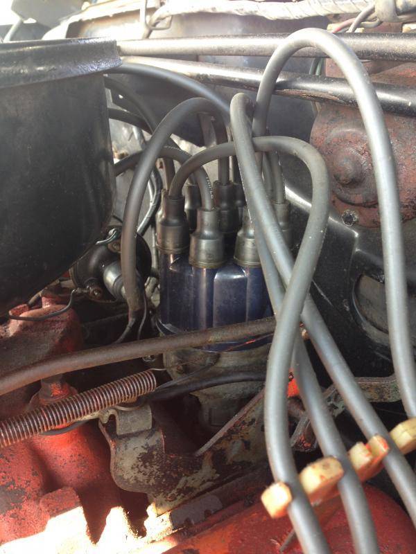

Thanks, I'll go order one of those now. Upon closer inspection there appears to be a new distributor or at least cap/wires.

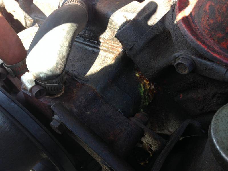

Took some pictures of what I believe is the coolant leaking, and also some possible leaking brake fluid?

Let's not get ahead of ourselves but appears to be some anti freeze here possibly from failed head gasket or even warped head if it's gotten hot enough. I don't want to scare you .. it's all fixable but I wouldn't be driving long distance until this is sorted.
I imagine a compression / leakdown test might be in order. Go back to Stan's check list though and let's take it easy
I'll let the real pro's take over on the diagnosis :)

I was concerned about that. I have a family friend who owns an auto body shop but is basically a general mechanic so it just needs to make the one hour drive to his shop and he's going to help me get a lot of this sorted out this upcoming week. Very exciting stuff.

Good luck with your car 68 Fury III. That coolant leak looks like it could either be a head gasket or intake manifold gasket. You can go about testing it a few different ways.Do you notice any milky looking substance in your oil? When you look into the radiator do you notice any oil mixed in with the antifreeze? You can also do a compression test as Stan stated and you can probably find a compression tester from Harbor Freight,Sears, or your local auto parts store. Youtube will have videos on how to do the test.There is also a coolant pressure tester that is available.It looks like a bicycle tire pump but it actually connects in place of your radiator cap.You pump it up to your rated cooling pressure(anywhere around 16-18psi,and look for the leak.It's not that hard to replace either one but you will need a torque wrench to install your parts back onto the engine. The Factory Shop Manual will give you lots of information.This would also be a good time to flush out your entire cooling system with a hose while the engine is running.Flush out your radiator,remove your lower hose to let the crud out of your engine,and replace your thermostat when done.I would also disconnect your heater hoses at the firewall and use a hose to flush out your heater core in "both" directions and it would be a good idea to replace your old hoses if they weren't done within the last 2-3 years.Best of luck!
