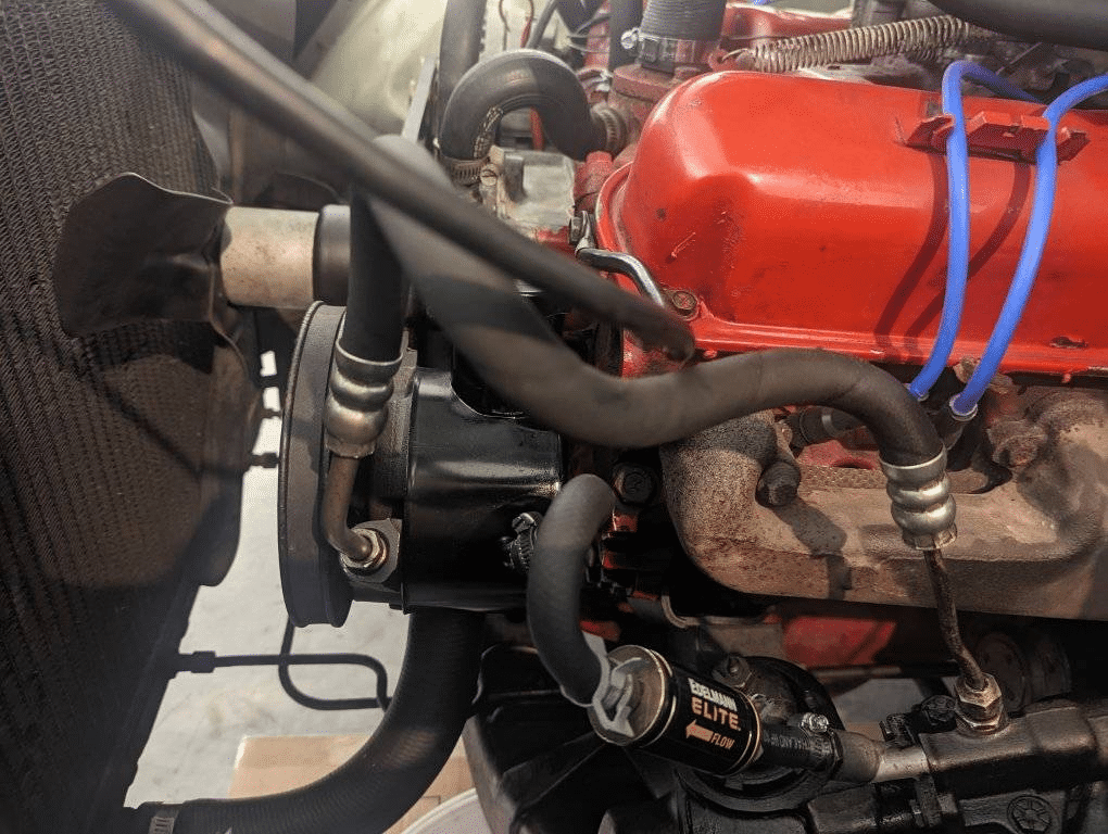

Tracking down one final slow leak that appears to be coming from the PS pressure hose but am running into some weird issues, and apparently I'm one of the few folks with a Federal pump (just replaced, brand new) on a 318. Here's the weirdness:
- The replacement hoses I'm finding are all 33"-36", the original is around 12"-15" (image attached). The hose I picked up that was supposed to work looks pretty goofy with the excess draped up against the wheel well.

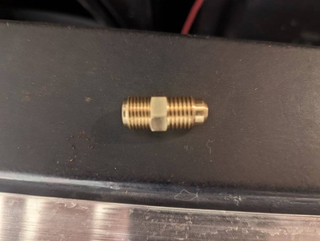

- All existing connectors are 5/8 or 16mm including the threaded adapter that goes into the steering gearbox. The gearbox end of the new hose and the new threaded adapter are both 7/16, and the new hose does not fit the old adapter.
Anyone else had this issue that knows what will fit properly?

You might want to take your original hose to a shop near you that makes hydraulic lines. They will make it the correct length & be able to match the fittings. FWIW the p/s hose on my ‘68 Fury with a 383 rests on the inner fender. Most others I have seen are the same.
Your short PS is from a late 50’s car. That’s not what came on a 1968. They were long and looped around. Plenty of flex.
Interesting.. That's what I was afraid of, thank you both. I've seen some NOS stuff that looks similar but I'll see about getting a different threaded adapter to work instead of worrying about what's there already.

I don't think this is the correct hose for your car. The angles are wrong and the length is too short.

Yikes well that's not at all what I wanted to learn after all this time, I'm certainly glad I asked! Sounds like I just need a different threaded adapter then and I may be all set. Thanks!

There are different size "adaptors" that screw into the steering box. Can't tell you what cars got what.... I had two c-body steering boxes, one from my '70 300 and one from a '68 Fury. The Fury had a smaller fitting on the steering box!.

On all of the 383s I've seen in those years, the hose leaves the pump at about 2:00 angle and heads toward the upper control arm watershield, then curves back around to head to the ps gear hose attachment. There used to be a soft rubber "hose" over the main hose to cushion where it might lay on body parts.
In some cases, the extra length can absorb/decrease harmonics related to the system and how it operates. Which can mean that the shortest distance is not always the best.

The only thing is that the hose in the pic is way too close to the exhaust manifold. You have to have it looped so there's no stress on the fittings and it's below and away from the exhaust manifold (heat rises). That particular hose might be OK if the pump fitting was clocked downward and the box fitting was bent over as I think it once was.

Neither hose looks correct. I have an NOS PS hose but I would have to look up the part number to confirm that it is a high pressure hose. Let me know if you are interested. FYI, I have 3 of them.
