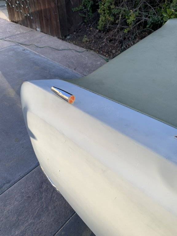

So, I received a fender indicator lens kit for the Fury for Christmas and I went to install it and it turns out its for a Roadrunner. I decided to try it anyways as it said it works for the Bullet Indicators and doesn't fit. The threads are different, which would be fine if it worked as I need to replace both anyways and I could remove the guts and use these. I tried plugging it in the bullet connector(I think thats what it is called) and it didn't work. I tried the good old aluminum foil trick to see if it was a connection problem and nothing. I tried putting everything back together and discovered the front grille indicator and the fender indicator didn't work now. I'm assuming it blew a fuse, but I'm not well versed in the electrical part. Any advice is greatly appreciated!

School started back up so I've had little time to get to the problem and the car demanded other parts when I had time. I recently drove the Fury through a rain storm and the front grille indicator decided to start working again so I'm not complaining. One question I had was, where would I attach a ground wire to? I was also wondering if anyone had pictures that they could share of where their passenger side fender indicator hooked up to. My car did not come with an affixed fender indicator when I bought it and I'm not sure if my wiring has the hook up.

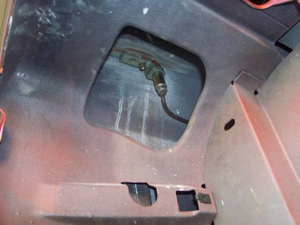

On my 68 Newport,I attached a ground wire to the stud/nut and grounded to the rad core support.
Shown here for clarity before extra ground wire..
