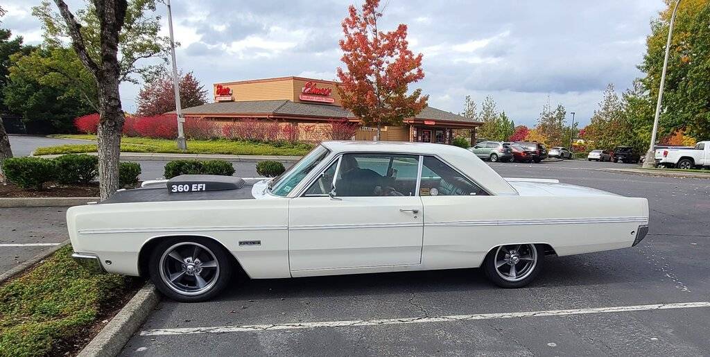

I finally got my new wheels on. 245/45r17 up front and 255 in the rear. All 4 on 8" rims. Nitto 555g2 tires.
I must say...the car feels glued to the road now. WoW

Having a good tire under a Slab can prove just how great the Chrysler front suspension geometry works. Add some good HD shocks into the mix and it can be really good! Plus some better brake linings, too.
What backspacing on the wheels?
Enjoy!

They said 0 Backspacing. However, cast into it was ET -1. So far they fit perfect with no rubbing. Its insane how this feels now with some performance tires on it!? I just took it out on the freeway and did barely notice I was doing 90!?

IMO those rims look awesome, way better than the ones I bought. Those could be a winner to replace the 15" torq thrusts on my charger. Again just my opinion, but a little more sidewall and it'd be a perfect look.

I absolutely agree on the sidewall! I guess if you go 16".. anyway I went with a diameter that was close to what I had and this does not look too bad.
I really didnt want any american racing or torq thrust because everybody has them.
