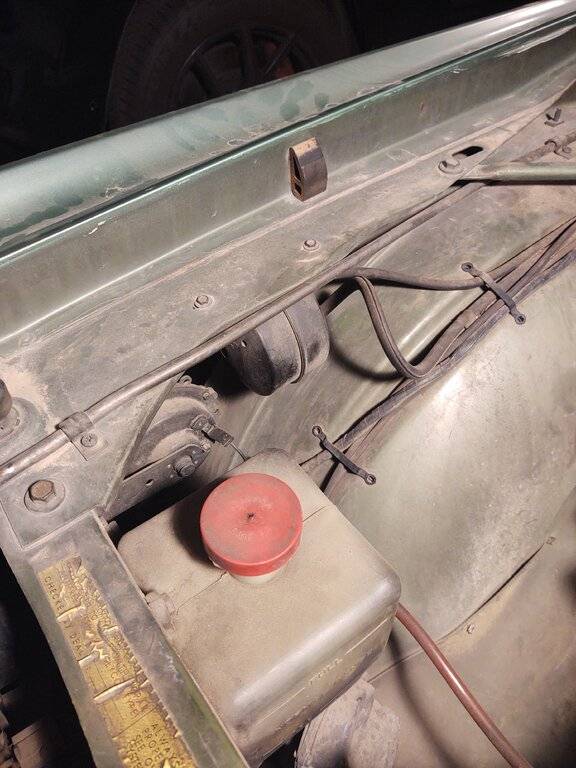

Also, in the second picture, what is this small black tank next to the horns for? It looks like a small vacuum tank of sorts. I'm NOT talking about the radiator overflow tank..

That’s a replacement voltage regulator to replace the old mechanical one, you may still be running points with that upgrade. The reservoir is either for your hvac controls or vacuum trunk release.

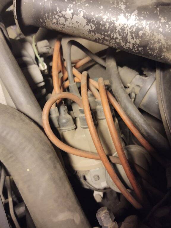

I was trying to get a look at the old distributor. it's hard to tell whether its electronic or points-type without removing the cap, or is it:
Agree, it's "points". Points have the black wire going into the distributor, factory electronic ignitions have two wires in that place, as I recall.
