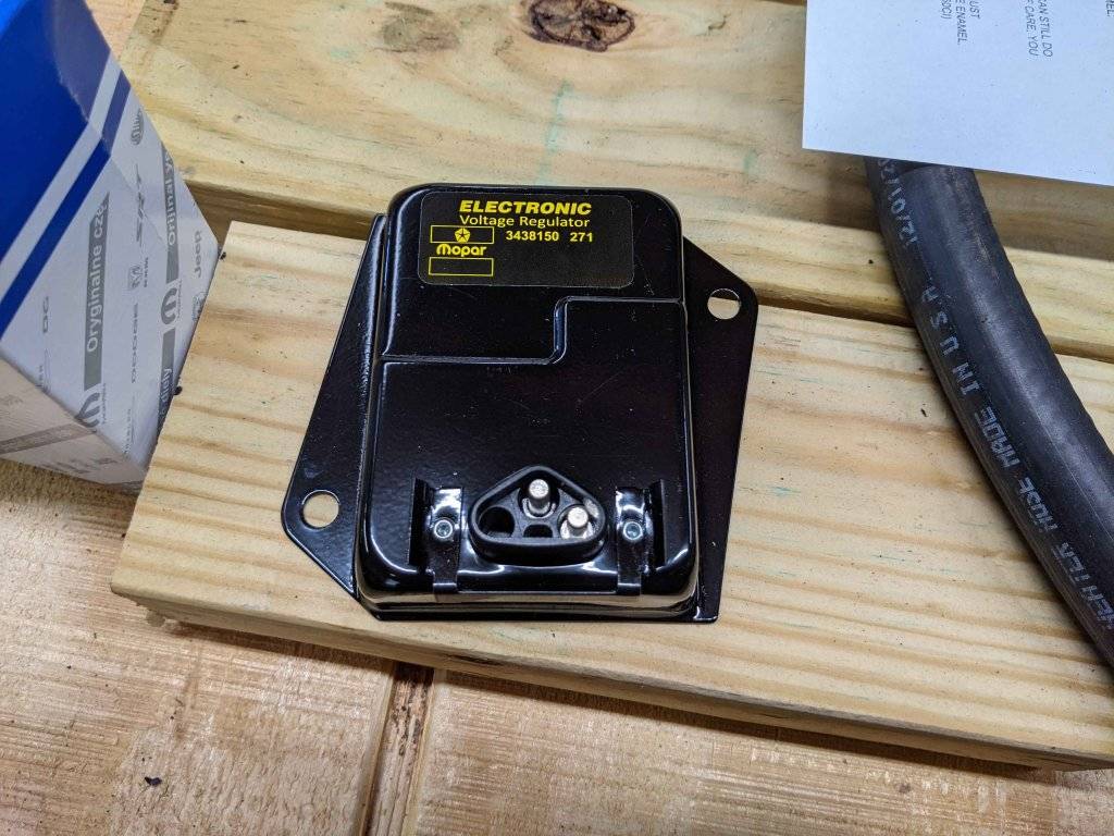

I think it's probably the voltage regulator, especially if you did not convert to the 1970 and later model flat pack electronic regulator. Image 1970 and later. Don't give up. We got this!
