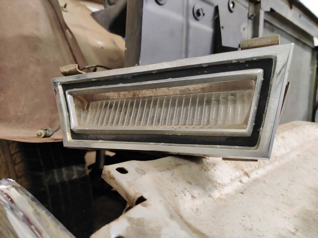

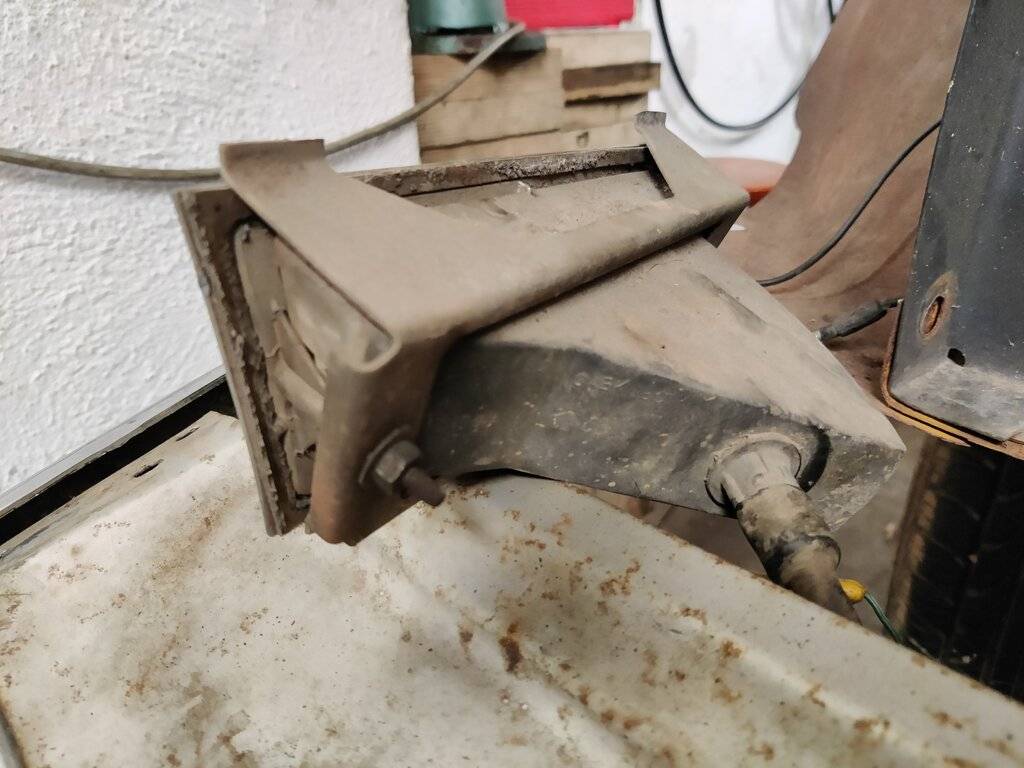

Hi all,
I'm working on my '68 Newport and I'm wondering how I can replace the bulbs in my cornering lights. I can rotate the sockets but I can't seem to get them out. Is there a trick to it?
The bulbs come out the front.
Remove the bezel and the lens should pop off of the housing.
You'll likely find that the foam gasket between the lens and housing is in rough shape.
Jeff
Thanks! I took the front bezel off yesterday but it looked like it was one piece. I was too scared to break it. I will try it tomorrow :)
