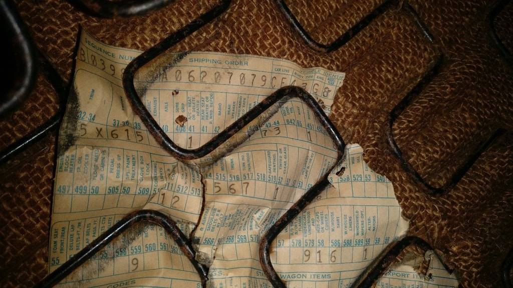

I still have the build sheet underneath the back seat!
It has been eaten away by mice partially unfortunately...

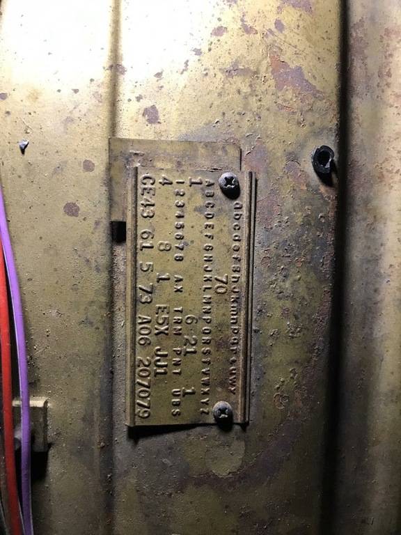

The fendertag is original and matches my build sheet.
Apparently the car's built date is from 6th October 1967 (A06). (Not 1968...)

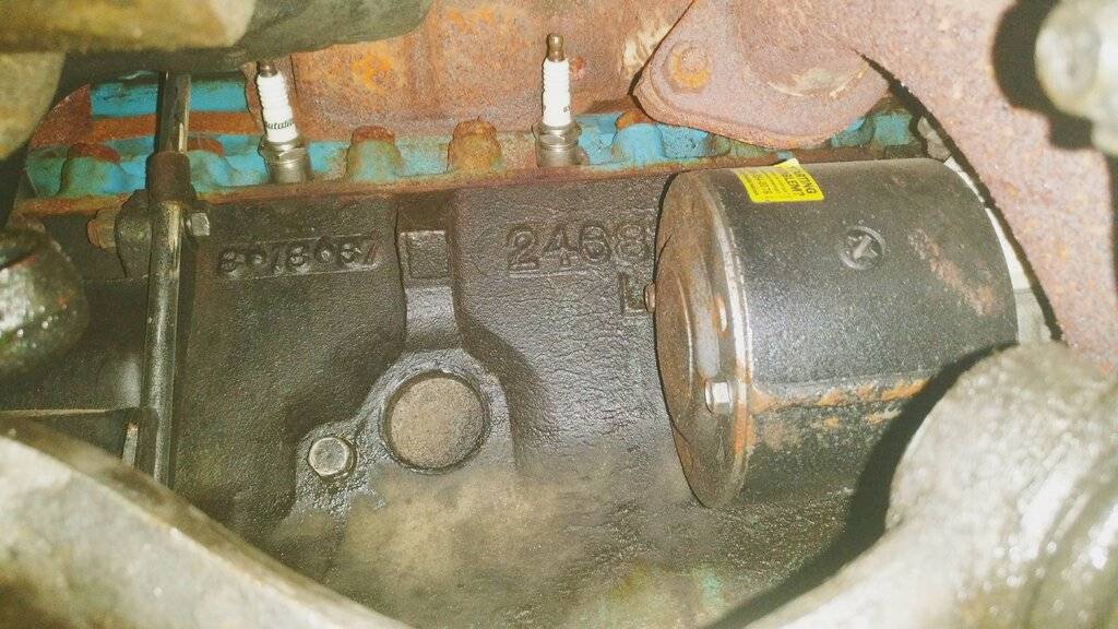

I've been looking for a VIN on my 383 engine but I can't seem to find one.
Looked at the back of the block next to the oil pressure sender, nothing...

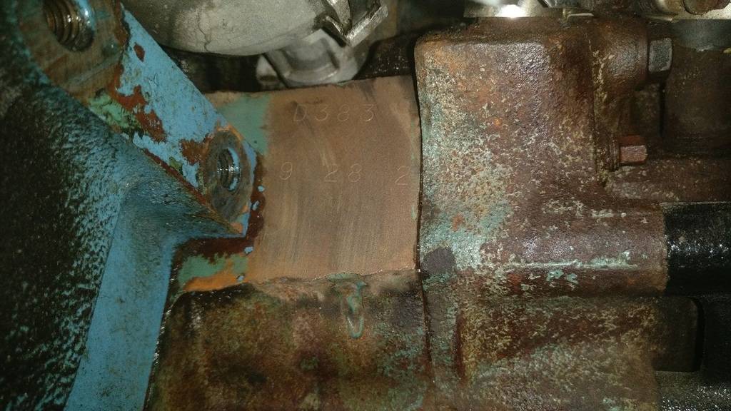

I also can't find a machined surface above the oil pan.
No VIN located there...
I did find the numbers next to the distributor.
It's a D383, so it's a 1968 model year block.
It's dated 9 28, (28th October), so 8 days before the date on the fendertag.
And it has an R which is correct since it's a 383 2-bbl 9.2 compression engine.

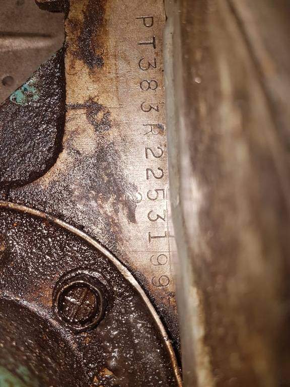

I've also found the Powertrain stamp on the bottom.
Z89Yl0ipJpHPnoVdmu3uy6DM_4HDTvJMgfogytq2V2BYNZgn9mtQcD8HyTvvyh1DKxVendxE=w732-h976-no?authuser=0.jpg
Are there any other ways that I've missed that confirms that this is a "numbers matching" engine?
No but I’d say you’ve proved your case but that’s easy to see as a Mopar guy. Unfortunately the people you have to worry about might want more convincing.
97 didn't have the vin stamped on the block and 69 did. 68 was a transition year. Yours may have a vin stamped and maybe not. If not, a date correct engine my be as close as you can get.

The fendertag has A06 on it, which means October 6th.
Does that mean October 6th 1967 or 1968?
I'm not sure since model year and calender year are different sometimes?
The reason why I'm asking is that the engine has 1967 casting and on the bottom what it seems like datecode 2253 which is September 28, 1967

"Does that mean October 6th 1967 or 1968?"
68 models started production the first of August of 1967 so 1967.
A October 68 produced car would be a 69.
Correction Toolmanmike. I think you had a mis type. August of 67 is 1968 Model year. August 68 is a 1969 model year as correctly stated above.
Ya, that's what I said just not too clearly. "Does that mean October 1967 or 1968?" It's like a 2 part question and can't be answered with a simple yes or no. LOL Thanks for your clarification. Your answer sounds much easier to understand.
@cbarge does your 68 383 have a VIN on the block?
Thanks. I forgot for a second that model year is not the same as production year... That makes things a lot clearer for me :)

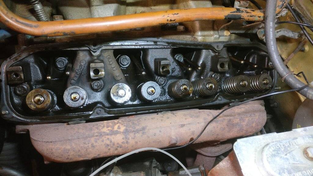

I took the valve cover off one of the heads.
Does this look like a 906 head with a really crappy casting number to you guys? (a 906 head is supposed to be on this block for what I know)
Yep, I’d say that’s a 906.
