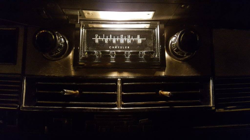

Every time I search for anything I get can't be found. Use error? Anyways I have a 68 newport with the stock am radio. Trying to figure out how to get the top dash off to remove. Can anyone help? Getting frustrated.

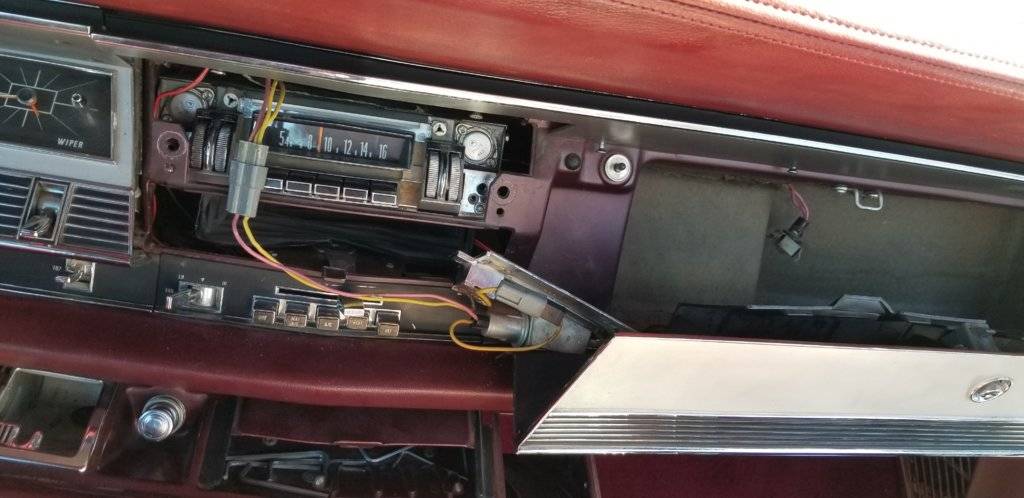

Just replaced my radio and speakers in the spring. The glove box removal is the way to go. Just be advised that they are very brittle. My glovebox literally disintegrated when removed, but I got a repop from Legendary Interiors. There are others out there, you can shop around. I had the AM/FM seek and search radio, which I saved for a future rebuild by Gary. I installed a Retrosound Am/FM w/ Bluetooth. It is a fine radio, but as stated above, the angled bezel is a pain with the volume and tuner shafts.

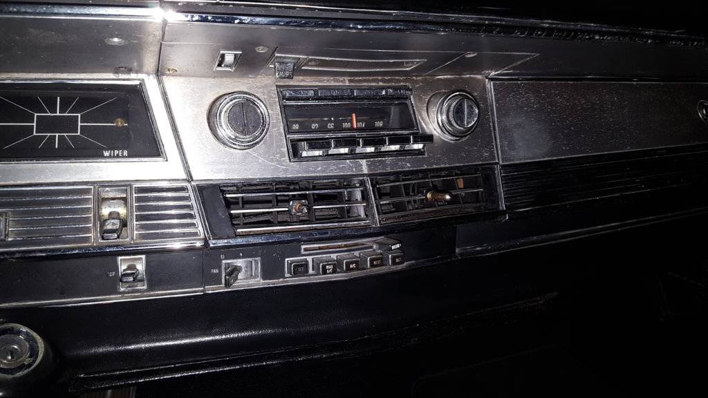

FThe Retrosound radio quality is fine, but I am posting before and after pictures for you to decide if the look is for you. I did not want to alter the faceplate/bezel. So placing the mounting plate on the outside of the bezel worked for the shafts. It just didn't look good when placed on the correct inside position. I wanted music for the summer and didn't want to wait for a rebuild. Lesson learned. I am not a big fan of non-stock look, so when I get some extra $ , I will send the original out for a rebuild.
