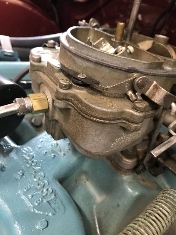

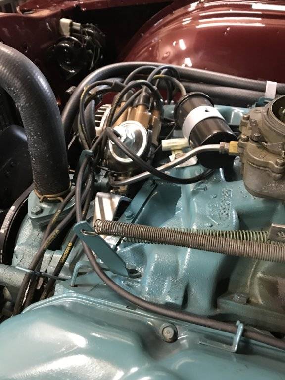

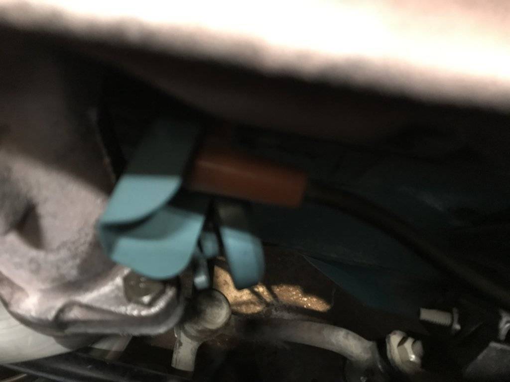

    A couple of easy things to check. To take the vapor lock question out of the picture, but @Big_John is most likely on the right track.
    If you want to minimize vapor lock potential here are some easy things to check.
    First, is your Heat Manifold Valve on your right exhaust manifold opening up all the way? If stuck shut, or only opening part way it will heat up your intake manifold enough to vaporize the fuel in your carburetor. Second, Is your fuel line from the pump to the carb laying on the water pump or intake. The heat from your engine can vaporize some of the fuel in the line. line should not be touching engine.
    Third, does the top of the fuel bowl have a little vent cap or flap that allows the bowl to vent when shut off or idling? Check those simple items first.

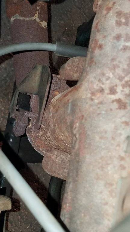

    I checked the heat manifold valve. Is it supposed to move and spring back? Mine just moves and stays where I leave it.
  15. HWYCRZR
    HWYCRZR Senior Member FCBO Gold Member
    Messages:
    1,564
    Likes Received:
    2221
    Joined:
    May 13, 2015
    Location:
    Fargo, ND
    It is supposed to move freely. There should be a spring coil that as the engine heats up it it tightens and moves the butterfly in your Manifold to the open position. When it is cold the valve closes directing the exhaust across the intake to help warm up the engine.

    Thanks. I'll pick some up tomorrow. That's my main problem. It doesn't move freely and difinetly wont return back to normal.

    78251
    Thank you! The heat manifold valve is the start of my problem.
  19. HWYCRZR
    Messages:
    1,564
    Likes Received:
    2221
    Joined:
    May 13, 2015
    Location:
    Fargo, ND
    Taking care of that should at least get you started down the right path to help solve some of the vapor lock issues. Spray the heck out of the shaft, springs and try to get some in the little pin holes on the manifold where the shaft runs through. Good Luck
