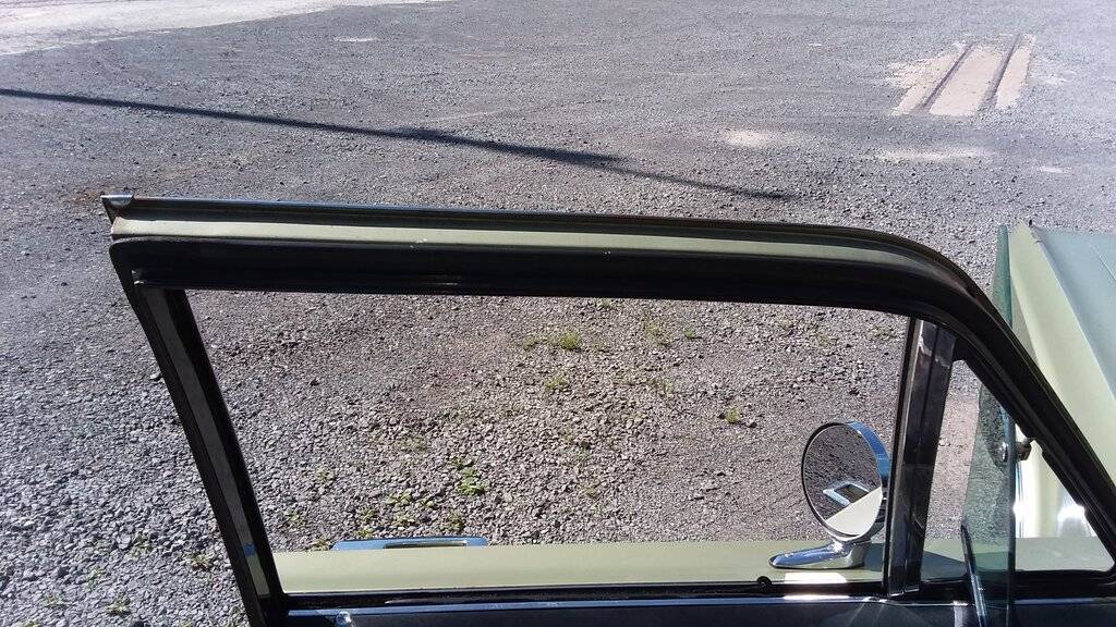

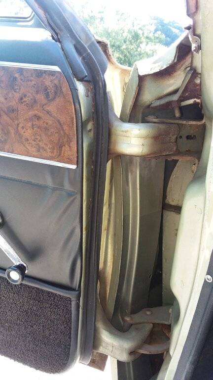

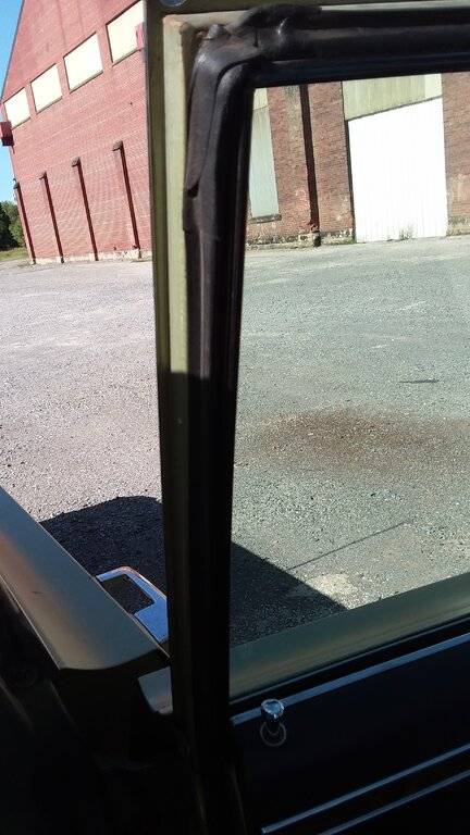

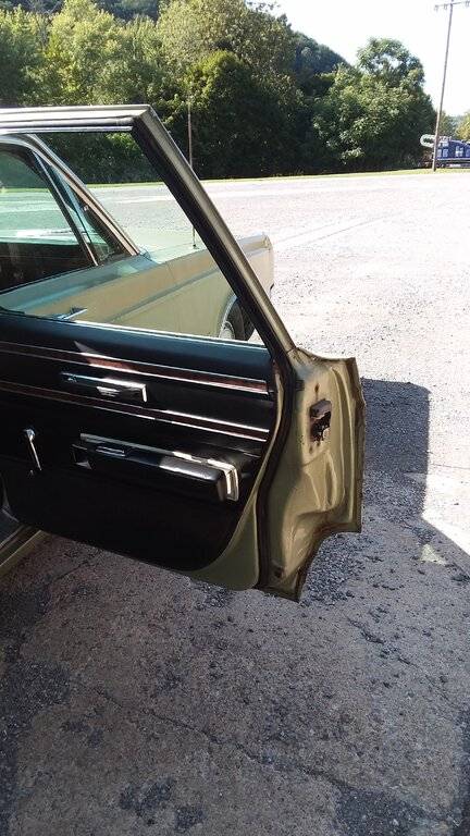

Here's some pictures that might help you. Front driver side and rear passenger.
