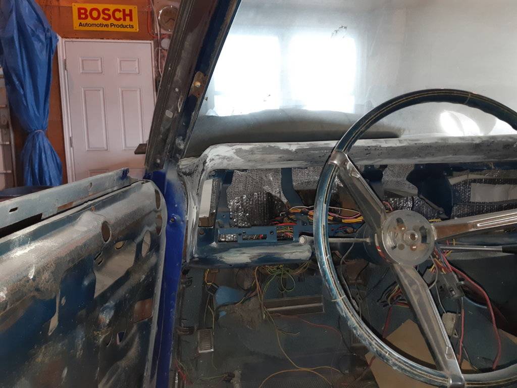

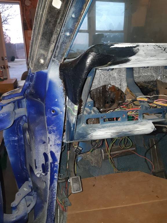

You are a better man for removing the dash pad without removing the windshield and dash frame. Getting at the pad's bolts I bet were PITA
The steering wheel you are thinking about are not cheap new or used. Thanks to all the 68-70 B bodies
Cannot imagine ,getting at the pad unless everything is stripped off dash and out of way. Worst part is I have had it off and on a few times checking fit. It's off now but I want to do final fit and paint in place. Hopefully next is last time.

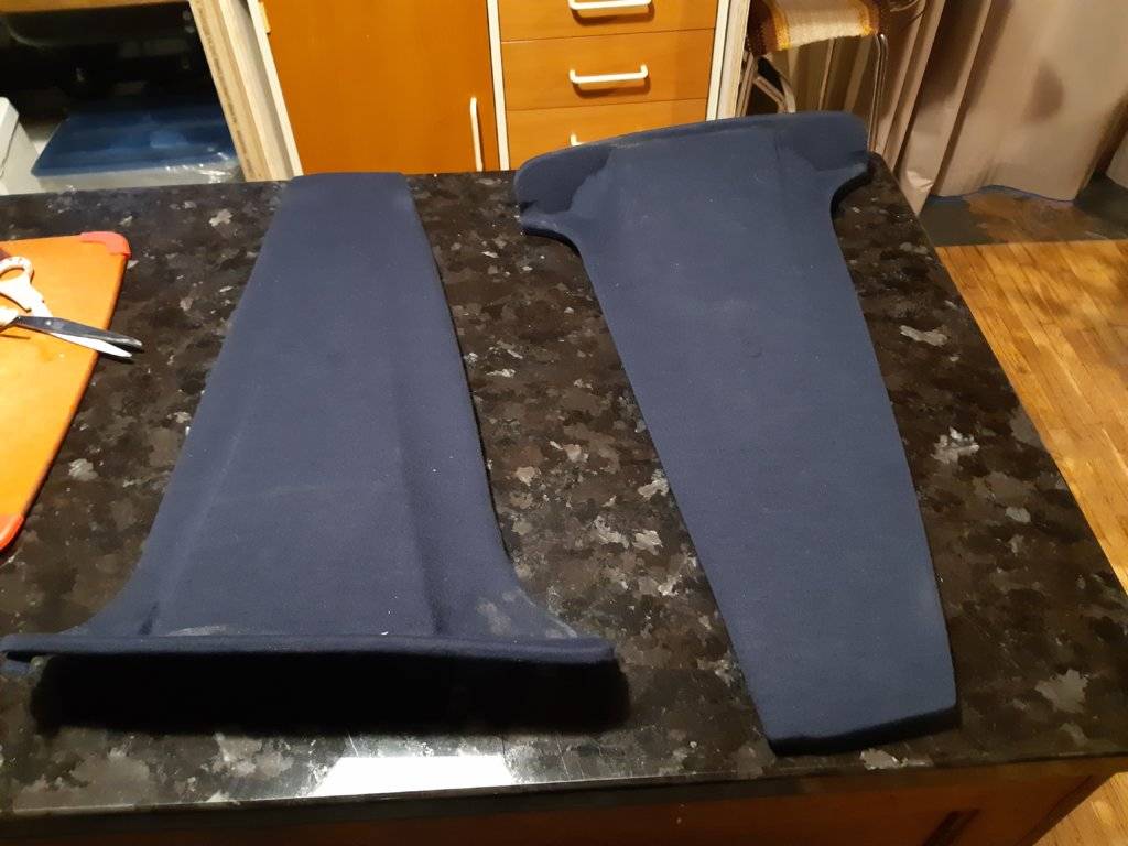

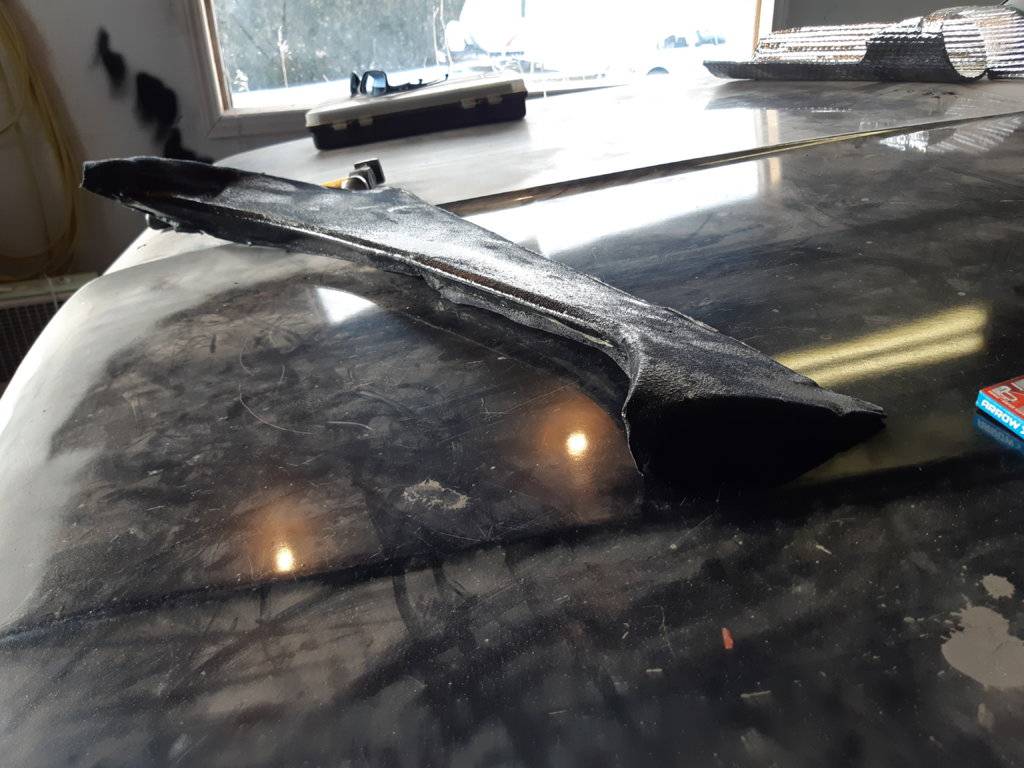

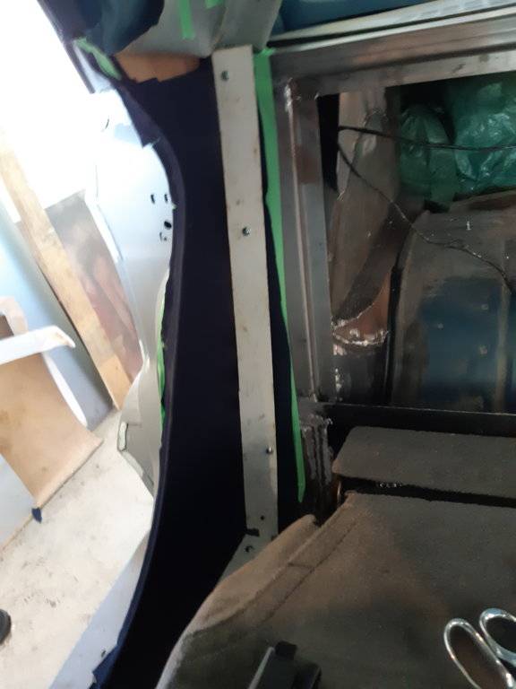

Polyester projects. Like the way the stuff worked on the dash so am covering or making other panels same way. The B pillar covers were cracked and getting brittle so trying to save them. Glue dried for a few days so will cover with resin today.

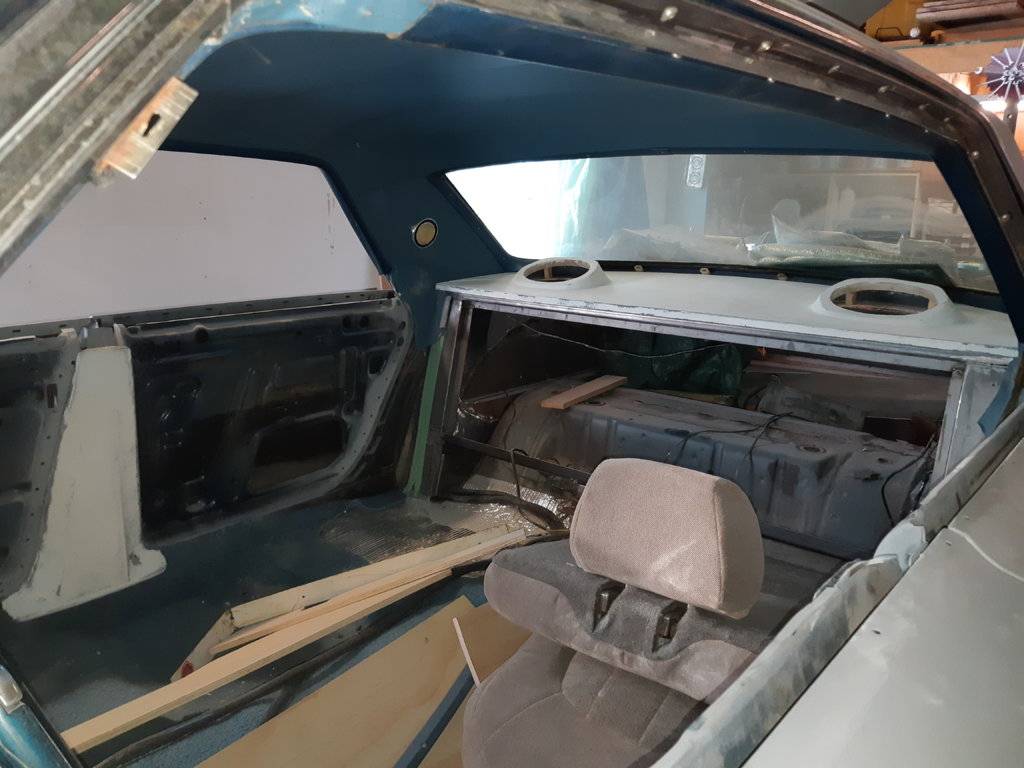

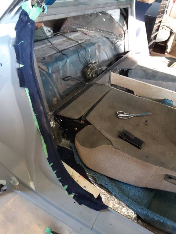

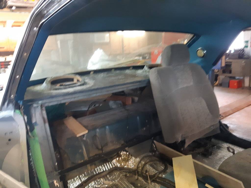

C pillar require new panels to fit modified rear so using just the front edge for molding and clothe the rest.
You may covered this already, but what did you pull the fold down rear seats from? I like it.

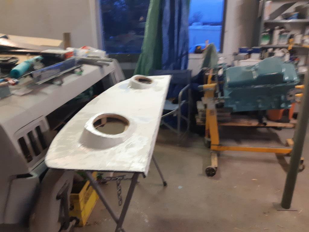

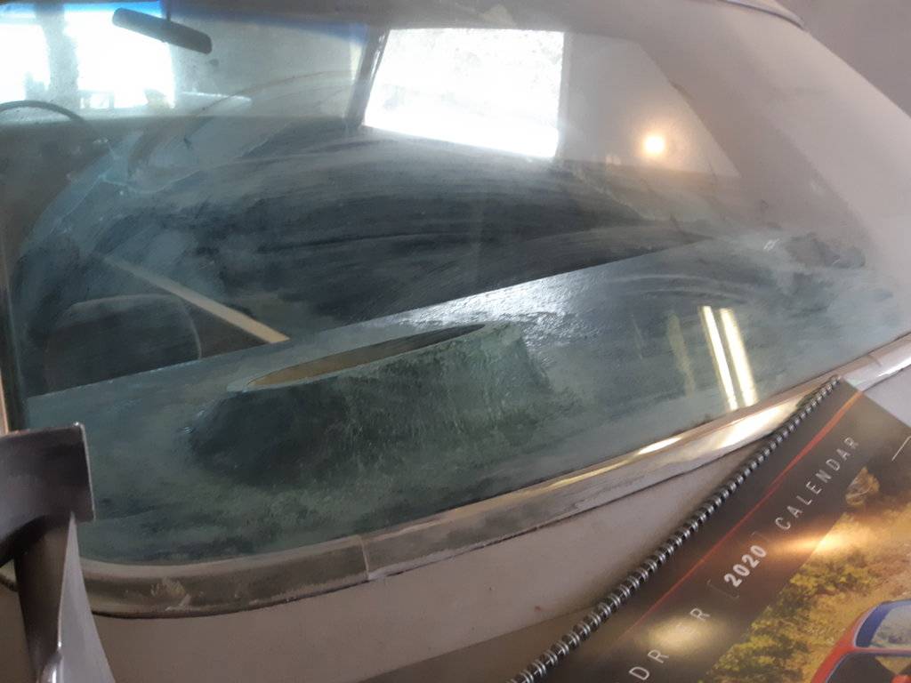

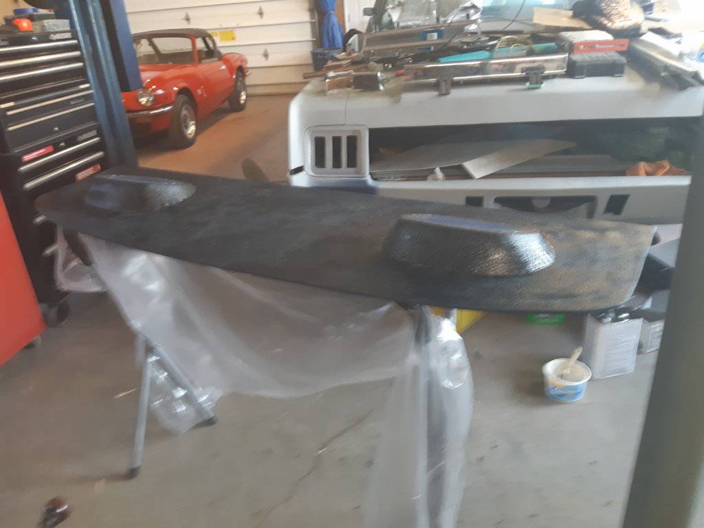

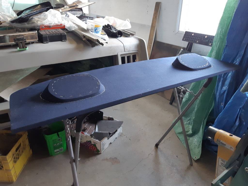

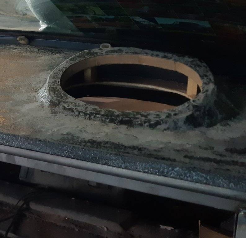

Some earlier test fitting. There is a layer of fiber strand filler applied over the speaker box part at this stage. The whole thing has been now top coated with polyester filler for final smoothing.
I didn't get a pic of inner structure but it is visible here. Its tha same as all the speaker tutorials online, which is basically a ring of MDF angled at the bottom and propped at the rear with wood supports. All just held by a glue gun.
I like it. I have seen the fleece/resin method before, but I have never tried it.
This is my first round with it as well. One thing is while roaming Fabricland looking for material I didnt like how thick fleece was and chose a thinner polyester cloth. Its crazy stretchy so a little interesting to nail down.
Glue alone has a hard time holding it in place on complex curves and shapes but it sure shapes well. Not many materials would have gone around dash corners.
Thinking a person could make really tough door cards this way.
Will probably do console sides the same with a metal/woodgrain top. Everything clothed will get painted factory frosty blue.

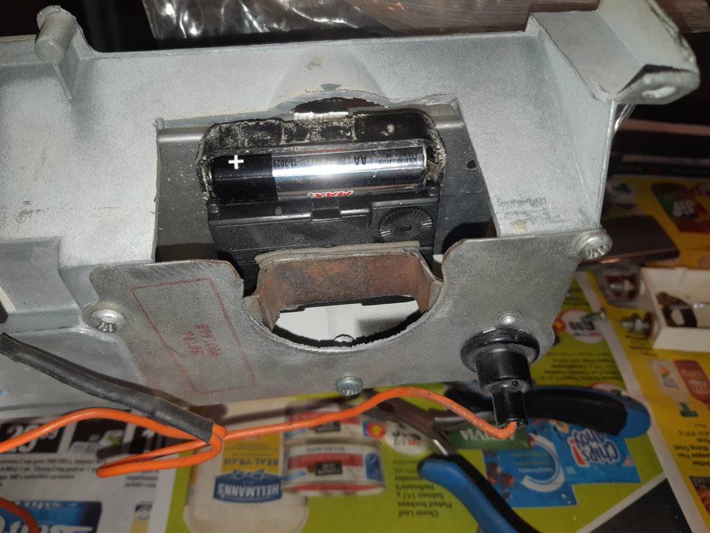

Started clean up gauges and found this clock repair I had done a few years back.
It's basically one of the std AA driven clock mechanisms fit to original face. Bit of a hack but cheap and reliable so works here.
Prepping rest of face for wood grain and repaint.
