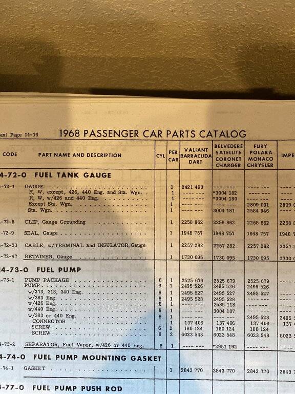

    Hello Fellow Mopar enthusiasts.
    I'm curious if anyone knows if a 68 Chrysler 300 fuel tank sending unit, is the same or will fit in my 68 chrysler newport (originally 383). I suspect 5/16 vs 3/8, and the answer is no, but thought to ask the collective first.
    Also correct part number if handy.
    Many thanks.
    Mike

    ‘68 Dodge, Chrysler, Plymouth C-bodies are all the same except wagons. 2809031 for all C’s except wagons.
    Yes it is called fuel tank gauge in the parts book. It is the sending unit.
    A parts book is a valuable asset and can be downloaded for free at my Mopar.com
