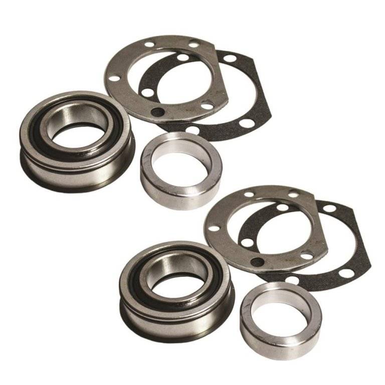

Would be a good time to go with Green Bearings. My passenger side bearing failed on my Newport. I made the switch with no regrets.

Green bearings are the sealed units, no adjusting required.
I don't understand the green bearings. If they eliminate the right adjuster, why is an adjuster needed anyway and why can't I use a left axle flange and just eliminate the adjuster anyway?

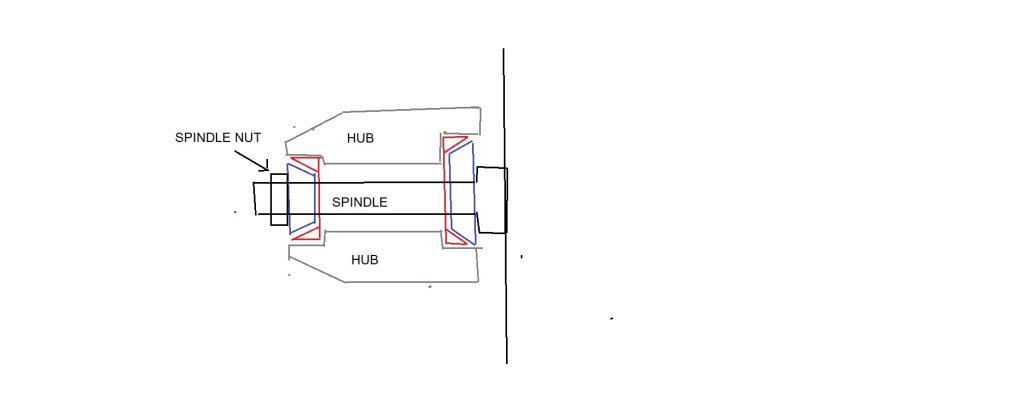

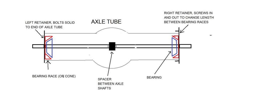

The factory rear bearings are tapered rollers same as the front wheels. On the front wheel, you have an inner and outer bearing on each side and tightening the spindle nut pushes them together. Too tight and there is too much friction, too loose and things are wobbly. On the rear there is just one bearing on each side and the adjuster is like the spindle nut.

The "Green" bearings use round ball bearings with the bearing housing controlling the side to side movement, so the tolerances are built into the bearing already, so no adjustment is necessary.
