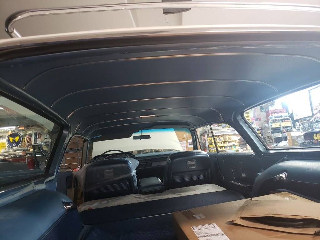

They one in the 64 lasted over 50 years with no problem. I also got one from Rem and fit great it will outlast me by a long shot. View attachment 557190
I like that yours is color keyed. Most of the ones before your model year were all white perforated hardboard which also was a turn off to me. yours looks much better being color keyed. If you keep yours in a garage all the time, it should indeed last a lifetime. Few cars ever received such care.

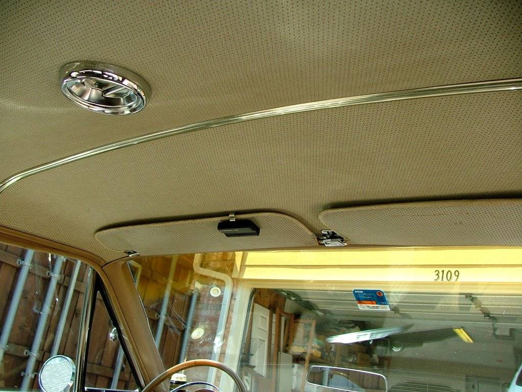

My original 66 headliner is in very nice shape after 56 years although dry climate living helped. If the replacement pieces are comparable quality I would think that was a good investment.
Dan's and Don's wagons clearly have had excellent care over time and were kept out of the burning sun for any lengthy intervals to look as mint as they do. 95% of the cars I see with the perforated hardboard headliners after some 50 years are just junk and falling down.
