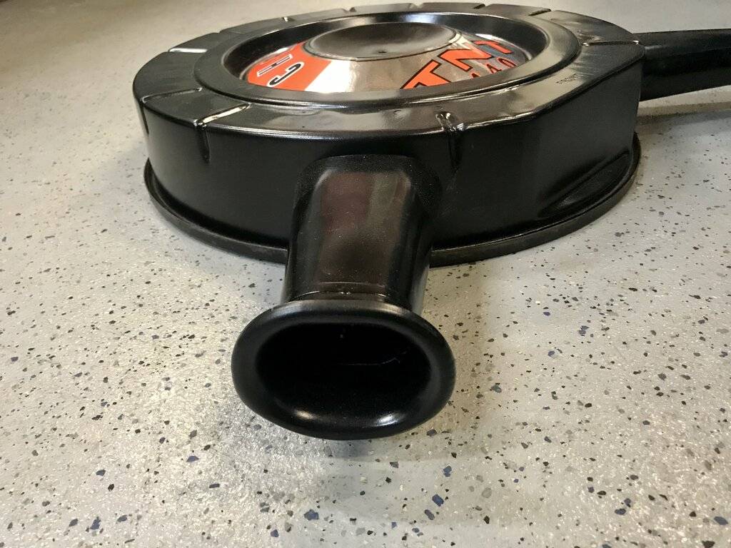

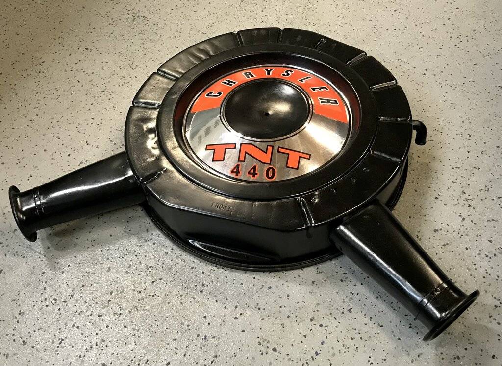

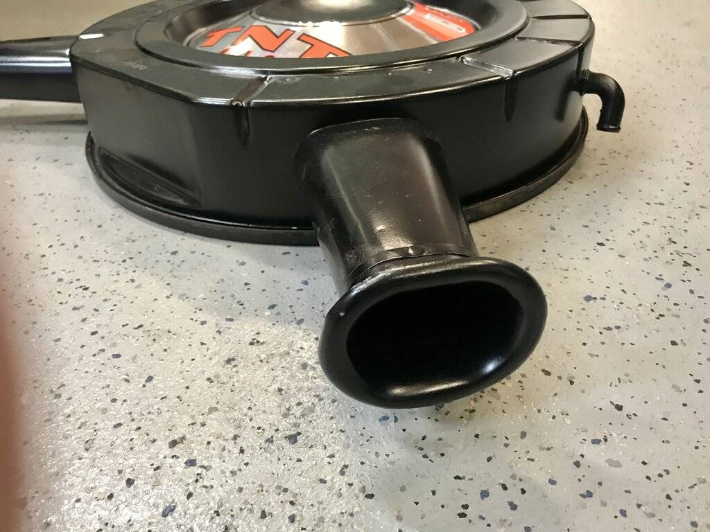

I have a 69 dual snorkel and base with a 69 correct orange 440 TNT decal for sale $400 + $40 shipping to lower 48 USA

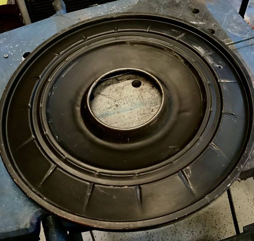

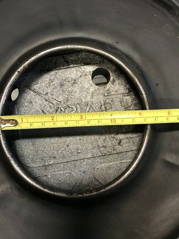

Any factory air cleaner from 1968 and later (with the "Holley-sized" big hole, as pictured) will fit and work. Might not be exactly correct, though. Especially on a 440/350 engine. FWIW
By the same token, you can take a single snorkle factory air cleaner, in the "base plate/upper housing" configuration (as pictured) and put the baseplate from a '68 Road Runner air cleaner (same filter element, but nothing to touch the bottom circumference of the air cleaner housing) and have an incognito open-element air cleaner. I did that on my '67 Newport 383/325 after I found a RR 383 air cleaner at a swap meet ages ago and then combined that with a dual snorkle top (also swap meet item years ago). Unless you look for the bottom plate's outer lip, it all looks good. My car had the factory "small hole" AFB on it, so the air cleaner needed upgraded when I put a 9801S TQuad on it, on top of an Edelbrock Torker 383 intake.
