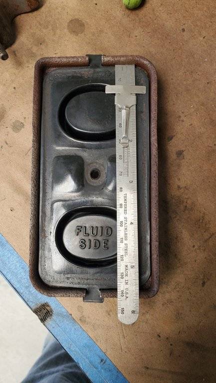

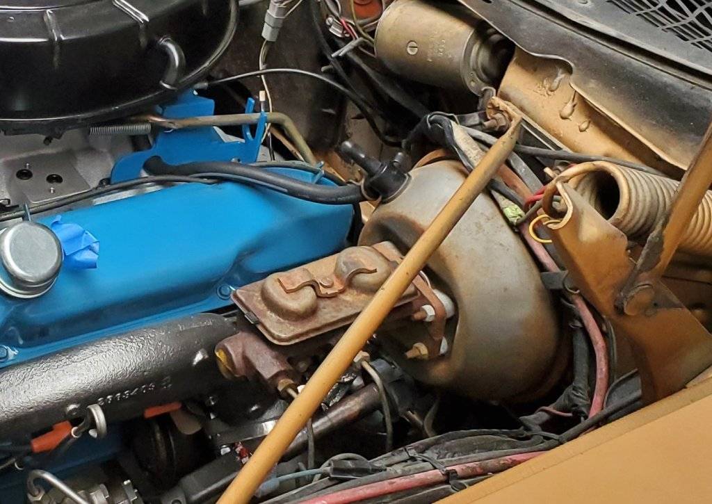

69 Chrysler 300, Power Drum Brakes. Rectangle with bolt hole in the middle. I'm striking out trying to locate one. Any ideas? Thx

It's a Bendix master - known as a double hump. The part number of 2660809 would be correct for your 69, even though the listing above from the Ram Man has it as 71.
Again, what's wrong with the original in you picture? Often it's the surface of the master cylinder that is knicked or uneven, and they leak no matter how good the gasket is. I cleaned mine up with a file and no more leaks. Protect the reservoirs and fluid from filings of course...

IMHO, if the top gasket looks that bad, all the rest of the rubber (piston seals) are probably close to the end of usable life.
IF the main issue is a gasket seep, then perhaps lowering the brake fluid level in the cylinder reservoirs a bit might work, possibly?
