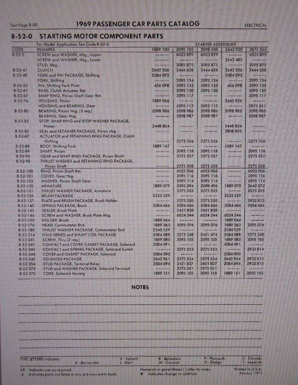

Looking for a 69 Chrysler 300 Starter Relay.

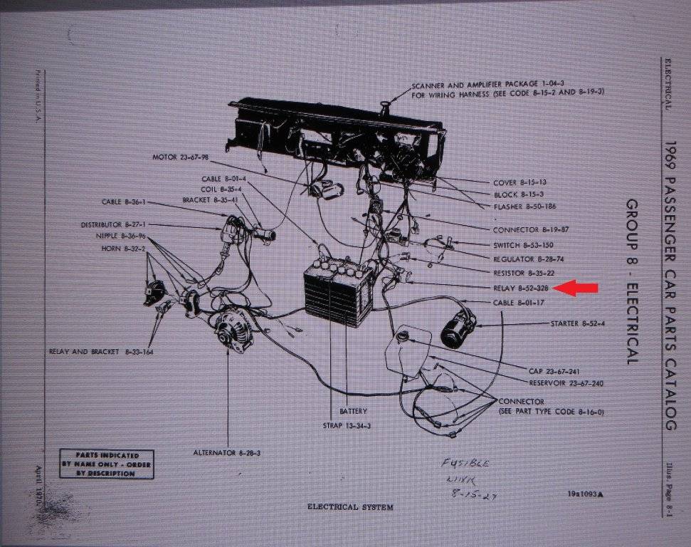

Started in the Parts Manual where I found 8-52-328 (I presume this is the Starter Relay?). Unfortunately 8-52-328 isn't listed in the 8-52 Page.
I then Googled 1969 Chrysler Starter Relays and found two Part Numbers (perhaps there are more?) #2875618 & #2875619. What is the difference between the 18 or 19?

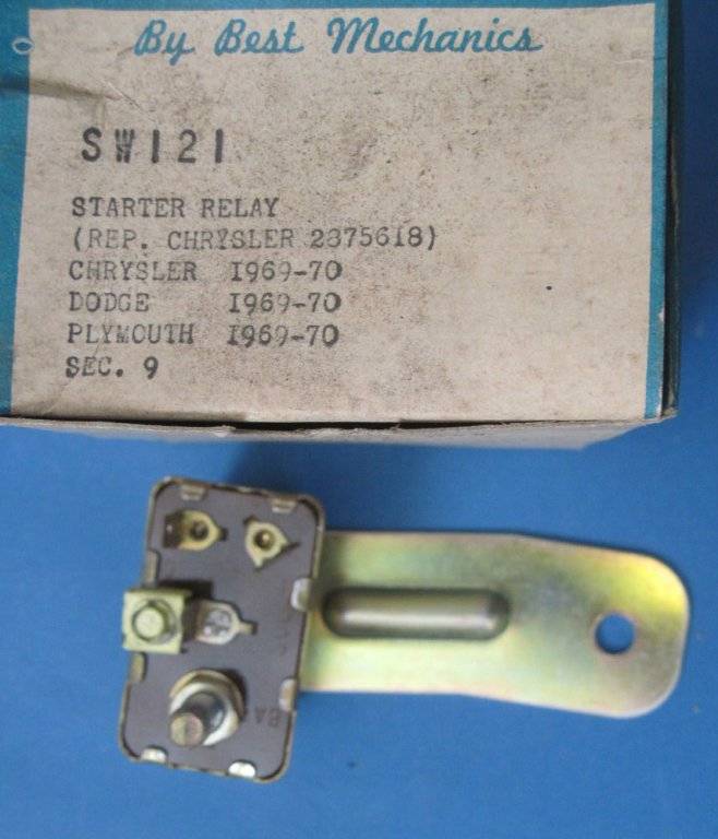

Tough to tell from the photos. --- but , if the top one is 4 prongs total ---
It is for A / T .....
If the bottom one is 3 prongs total ---
It is for M / T.......
If you backed up one page you'd find it, you were in the middle of the Starter parts
2875618: Automatic
2875619: Manual
You can use an automatic on a manual but not a manual on an automatic.
