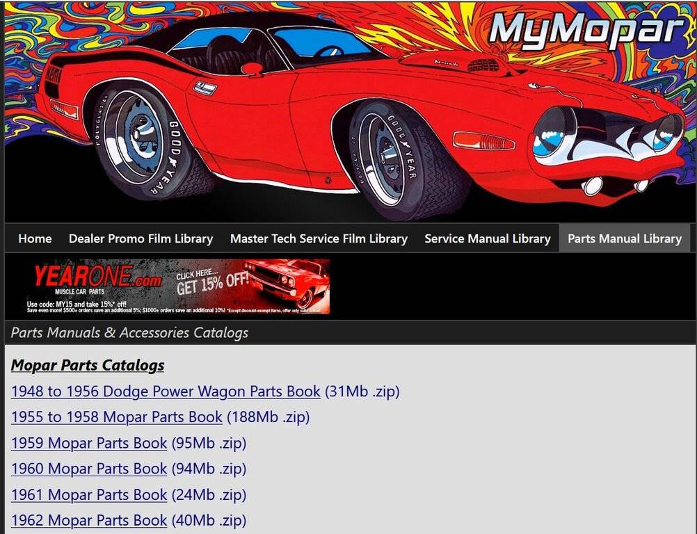

You can download a 1969 parts manual for free from MyMopar.
Parts Manuals – MyMopar

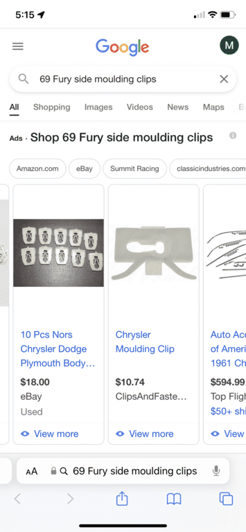

Reproduction plastic clips that attach to the weld studs show up from time to time. They will look something like this. Hopefully someone with a 69 fury has a clip they can take a picture of. To get the right shape.
Thank you all for the help.
That is really what I am looking for. A picture of a known good part will go a long way.

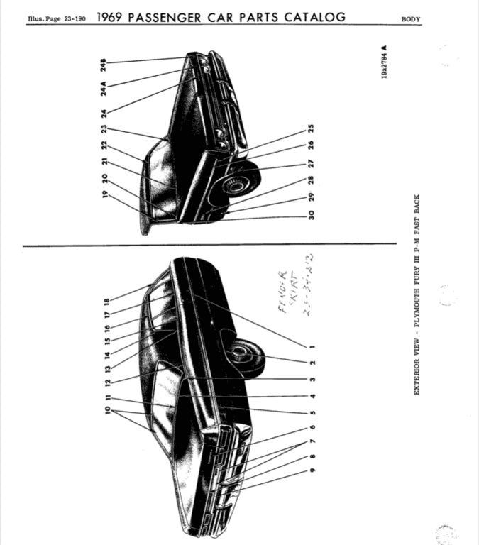

I have reviewed the catalog and here is the summary and pictures for others who may be interested in other moldings for the 69.
No luck yet searching against this part number but I am sure I just have not hit the right site yet.
Fury side moulding clips (retainers)
page 746,747 : 69 Mopar Parts Catalog
26 Fender : Qty 5 Part# 6002 633 (need 2)
1 Doors : Qty 10 Part# 6002 633 (good for both doors)
5 Rear : Qty 20 Part# 6002 633 (good for both fenders)

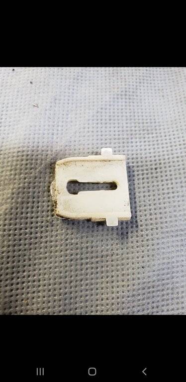

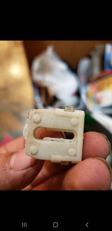

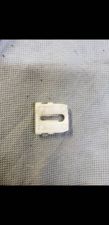

These are off a 69 convertible I stripped a few year's back. And say 6002 633 on them so these are the style you need to look for.
