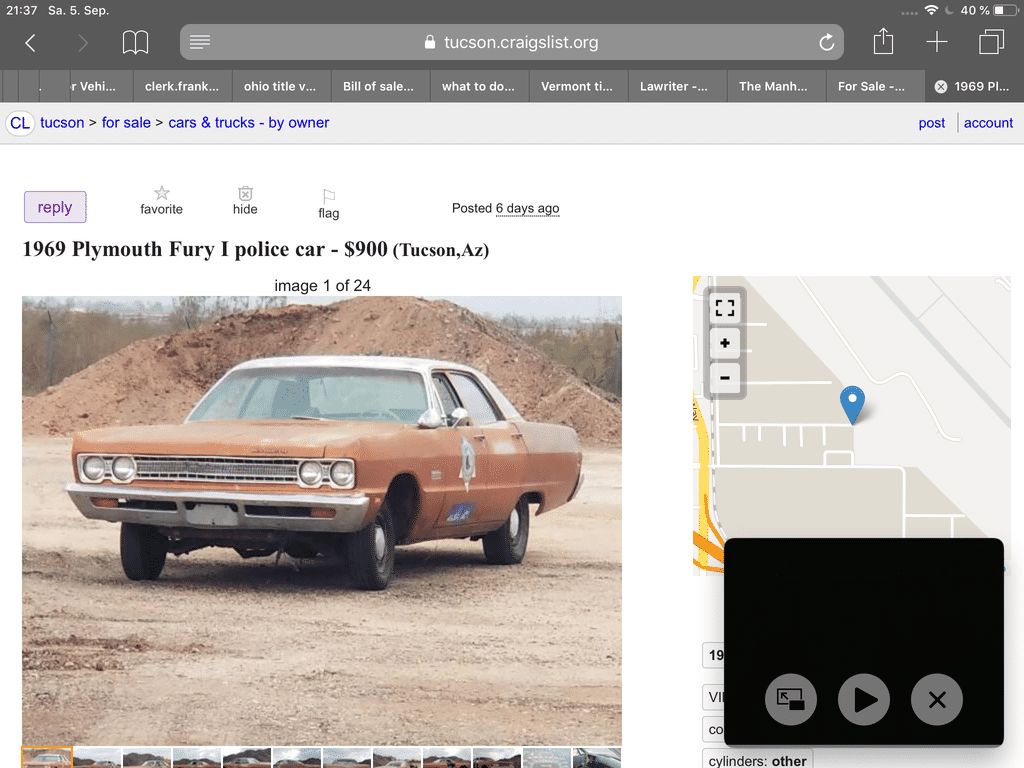

As some might know/remember: I am the crazy guy who bought what was left of a once pride Plymouth Pursuit.
Car did cost 900$ and had very rare options as proofed by the non existing fendertags:

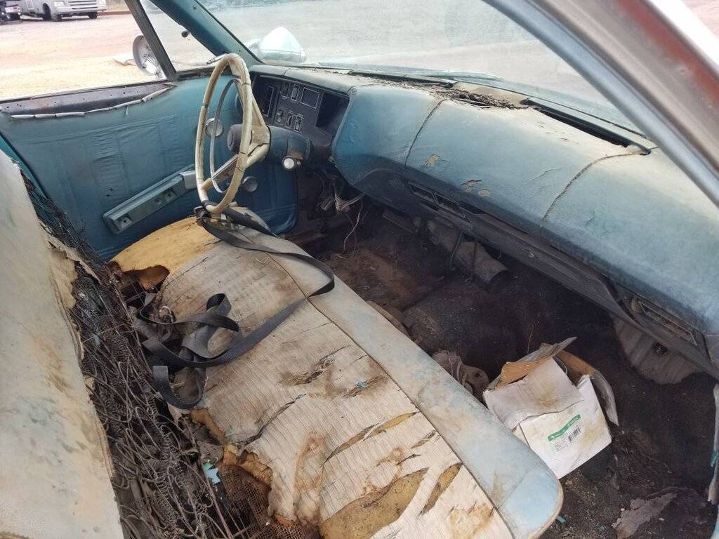

- code “PO5” => a piece of $hit interior, totally burned by the AZ sun and filled up with rat-poh
- code “E99” => the famous “99% of all ex cop-cars were gutted for their drivetrain”-option
- code “H1U” => “history unknow”-option, after being gutted, it was left abonded for I don’t know how long, person I bought it from had bought it himself to make garden art out of it, neighbours/muncipality did not like the idea of such art, so he decided to sell
- code “N0K” => no keys at all
- code “M1D” => missing passenger front door, I guess due to its Sheriff-graphics it is now wall-art in a Bar or in somebodys mancave.
- code “N0T” => no fendertags, but one can see it once were 2, probably now hang arround somebody’s neck as necklace as in the style of military-ID-tags.
- code “NOB” => no buildsheet, que surprise!
You get the idea: a real trash-can and money-pit. Only pro’s except for being a PK41 are the relatively good body/metal and a cool patina-paint.
I added a poll: would you preserve the Patina by just clear-coating (satin/matte) or repaint the car back to its (RARE!) original A4 silver?

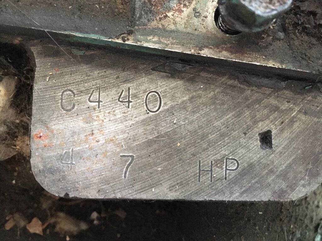

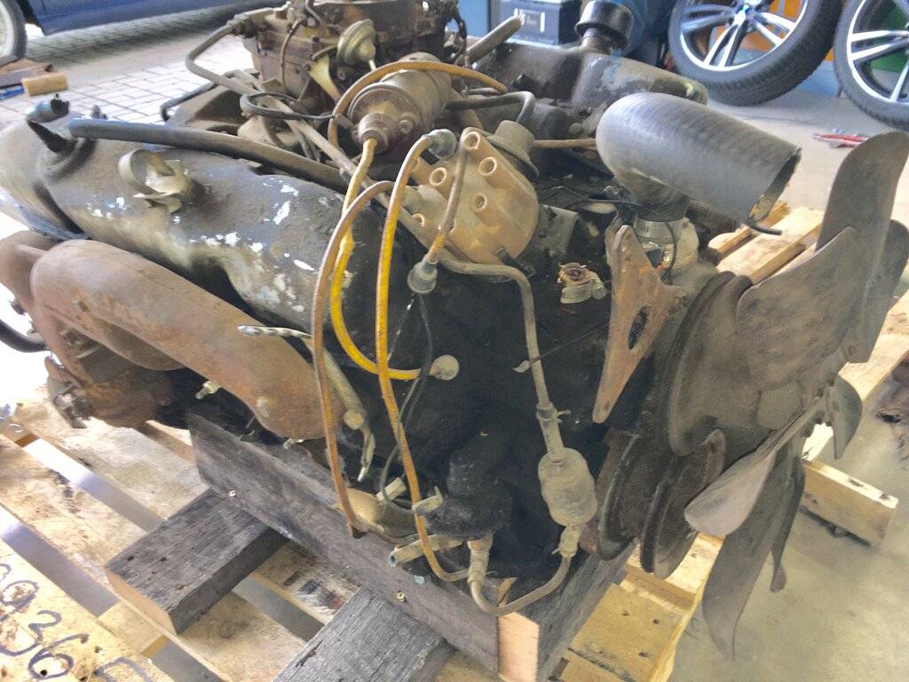

DRIVETRAIN:
the Gods were good to me as I could score a 440-Police-drivetrain that popped up on E-hay.
It is nearly complete from carb to pan, only missing the alternator, the starter and (not sure if it ever had one) the power-steering-pump.
Best thing is it is even a 67, meaning this is the only 440hp-version with the closed-chamber-heads. The same engine that was in the 67 GTX / RT...and yes, with chrome-valve-covers factory, even on a cop-car.

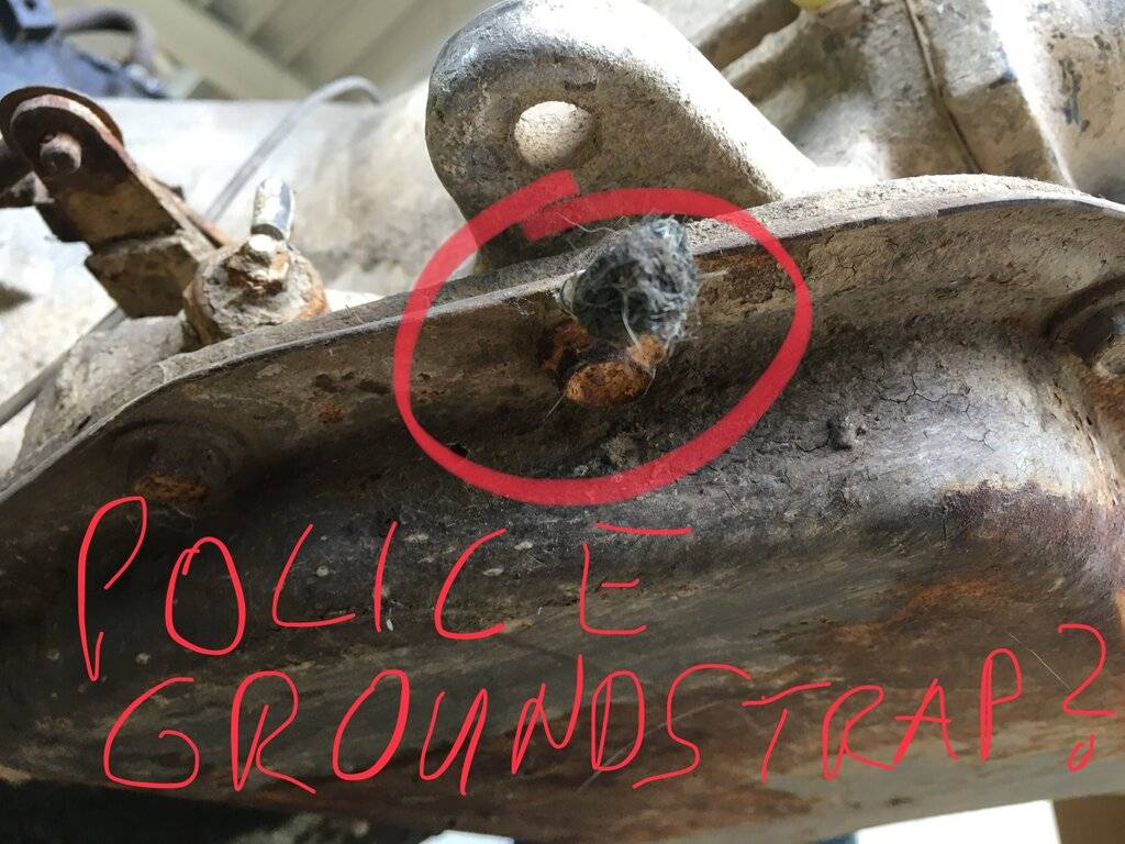

Some plugs have metal-heat-shields and there seems to be a ground-strap on trans-pan: are these police-only-things?
Also got an AWESOME surprise-present from engine-seller Jon: a Unity S6 police-spotlight, even with the ivory-handle which thus is a perfect match to my ivory-steering wheel.
Those heat shields are standard parts for all 1967 cars. The pass side is the same on all 67 440’s weather HP or not. The drivers side is specific to the HP manifold.

The interior is horrible and needs to be fixed up.
Thanks for that info, @413 !
