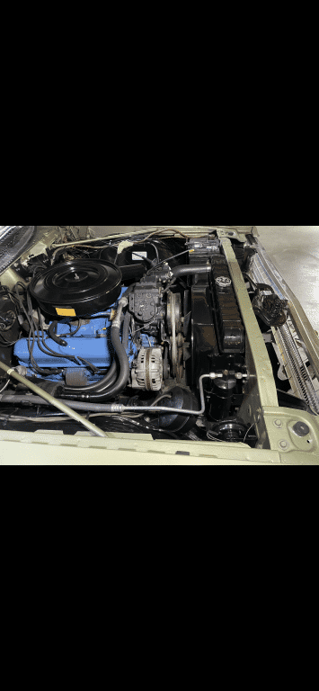

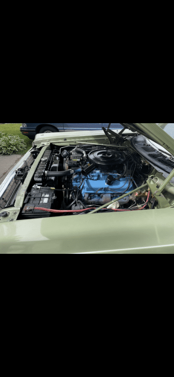

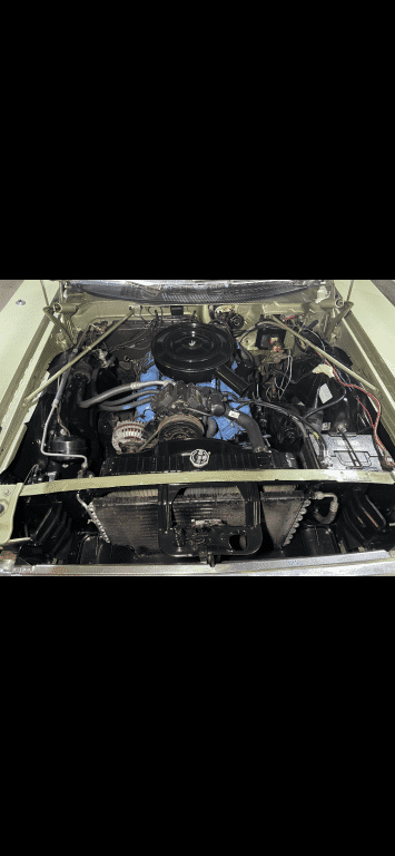

My paint job turned out perfect until I left the hood up and all the pollen hit it , l should of closed the hood and tarped it , it would’ve turned out beautiful , NBD I’ll do it again , a little more paint never hurt nothing, and I need to replace rubber on my fuel filter with steel as I read about that on a post here, most of the Mopars the filter in under the motor but mines on top. Getting new exhaust this week from manifold all the way back but she starts up great and is a blast to drive , now if I can get it to stop
