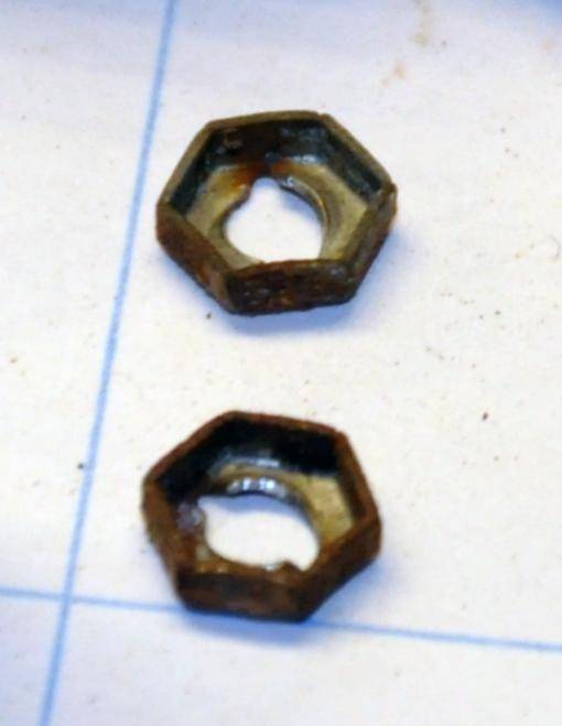

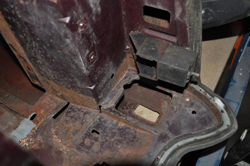

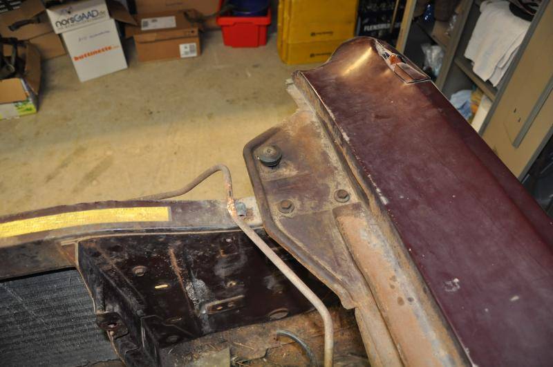

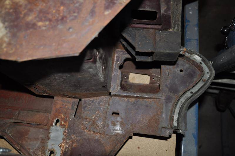

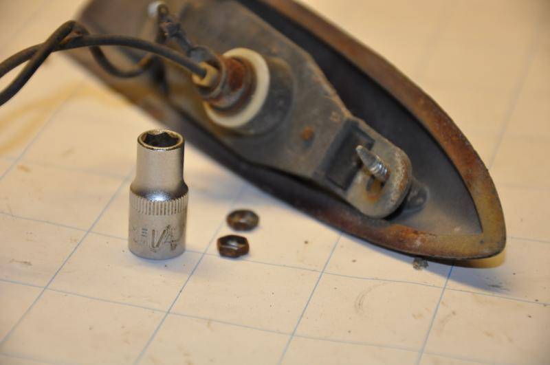

I made a few photos for you at the shop today to give you an idea of what you have to deal with:
You will need a 1/4 socket.
p.s. I don't know if you read this before you start but removing them will be the easy task, to put them back on will be a pain in the ***..! Especially because of these useless thin sheet metal nuts...

You have to use some sort of sheet metal nuts because of the coarse thread. No regular fine threaded nut will work here.
