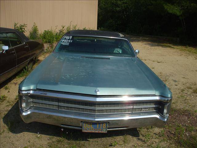

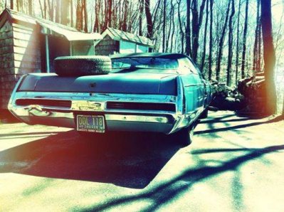

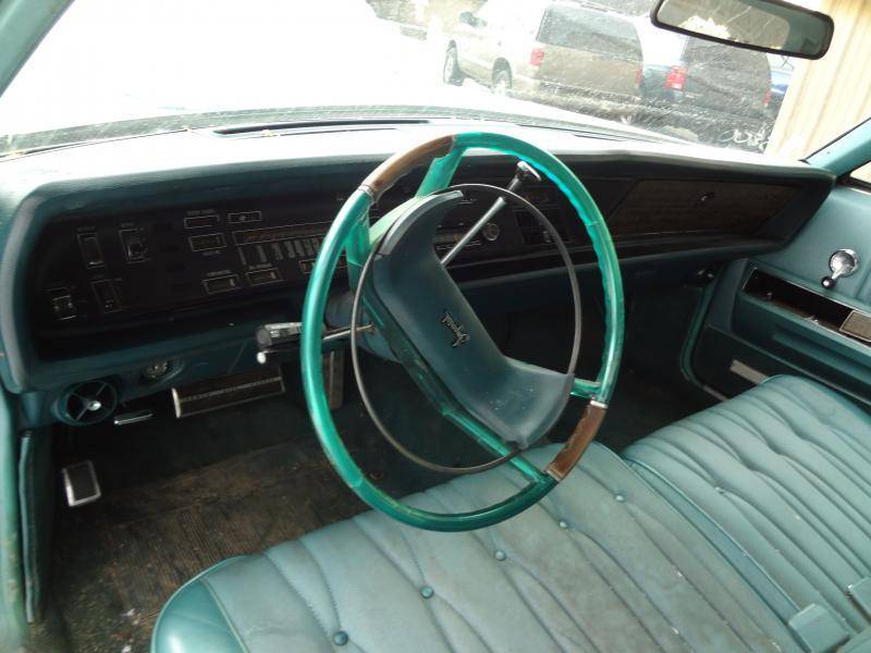

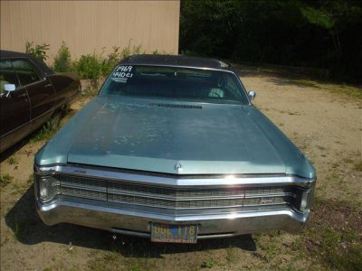

Here she is upon my first acquiring her.
Yeah, my niece saw that and couldn't help but take the photo. She thought it looked pretty damned upscale, too. :laughing4:
Yeah, I think that's where I found it. As it had zero rust on it and decent miles (and ran and drove once the tires had air), I couldn't help buying it. The 69s are my favorite so now I've got one. I'll be using this site for help, no doubt!
