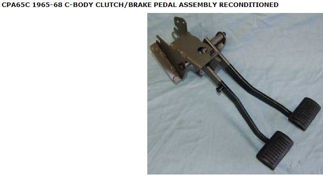

    It was mentioned here over 5 years ago, with pics in the posts of the two types...
    C-Body 4 Speed Pedals for Sale
    65-68
    69-70
    • Like Like x 1
    • Thanks! Thanks! x 1

    Thanks for the pictures. Sure would be nice to have them on the kitchen table for a close inspection. I do see different bend in 69 brake pedal. Wouldn't take long to bend and lengthen older brake pedal

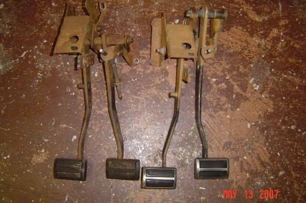

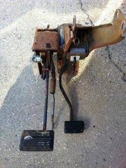

    Don't know if this will help, I'm not sure where this came from, (probably on this site), shows manual and power brake pedal sets side by side. Pedals.jpg

    Cool. You don't happen to know what year they are. I am going to look at engine side firewall on 66 polara and compare with 69 Monaco.

    Sorry, no. I believe the manual set is on the left but not 100% on that, I sure others will know. I have a 68 SF w/4 speed and manual brakes. I've been looking at converting to power but got hung up on the same thing.

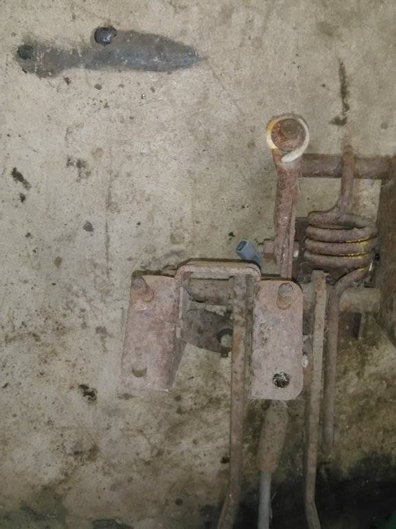

    Yea the manual ipedals on the left. I am sticking my neck out and say they 65 to 68. Could easily be wrong.

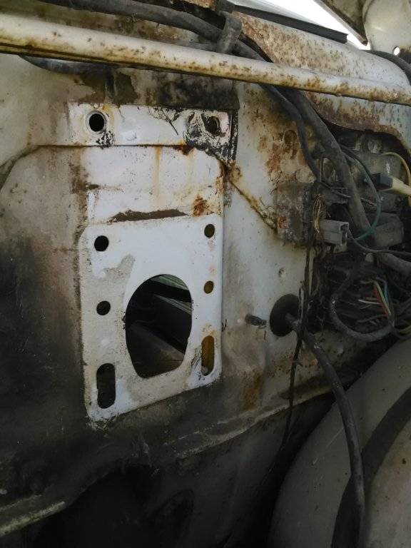

    It has been debated as to if 65 to 68 would fit in 69 and up. The white picture is 66 chrysler. You will see the area around were the brake booster goes is basically flat. I don't have a 69 with booster removed but 2nd picture is under the dash. Easy to see wide beads rolled in up and down.
    There is a good possibility that 65 to 68 pedal assemblies might work in a 69 but it sure wouldn't be a bolt in.

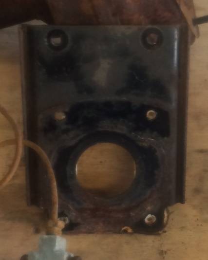

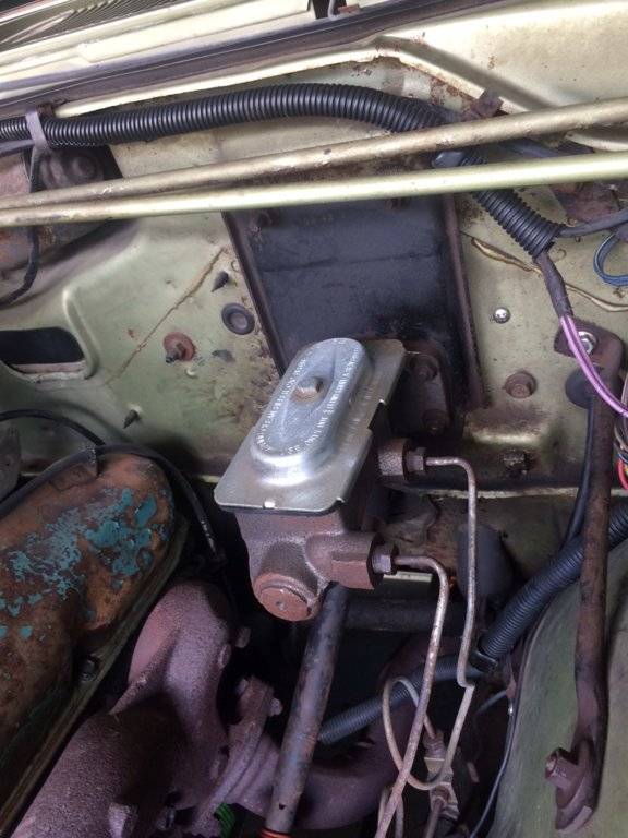

    Yesterday I posted that 65 to 68 pedals in 69 would not be a bolt in. I need to back track somewhat.
    Turns out I have a 72 polara that has the brake booster removed. Picture is attached. I did some measuring I don't see a big problem putting earlier pedals in 69 and up. . It's funny how a better view helps.
    But even if the pedals could be installed in 69 it still leaves the shortage of power brake brackets and pedals.
    So I am upgrading my previous comment and I figure 65 to 68 pedals could be installed fairly easy. But once again I could be wrong. I plan on trying the swap on the 72 polara. That way I will know.

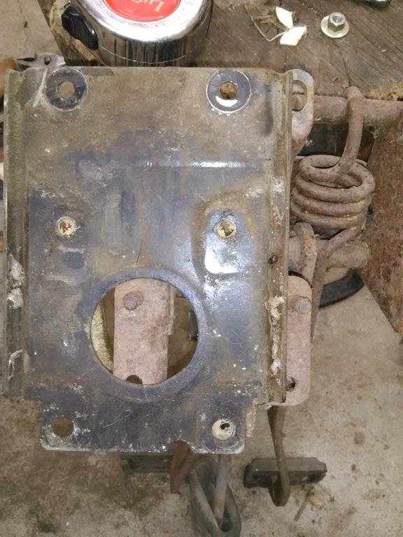

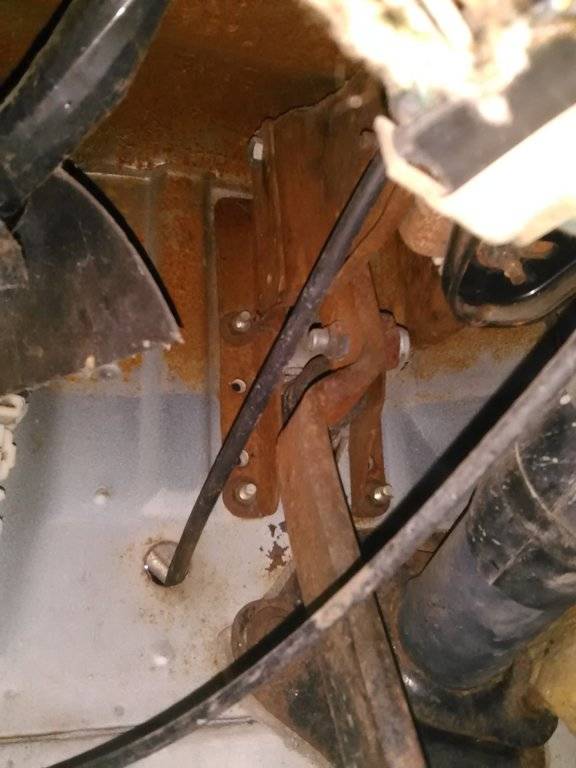

    Update to above post. Attached 2 pictureds.
    First one is manual break pedal set. You will see the 2 studs and 2 holes. As most will know this is what attracts the manual brake master cylinder.
    The 2nd picture shows the power brake plate sitting aprox were it would go but off to the side to show difference between manual brake master cylinder mounting studs and the lower bolts. On the plate you can see the 4 lower holes that the booster mounting studs to thru.
    This shows the modifications required to graft a booster on to manual brake pedal mounting bracket. Very simple. Also I should mention that the firewall already has the holes for booster mounting studs.
    I am still not saying that this is a done deal. But felt it best to update.
