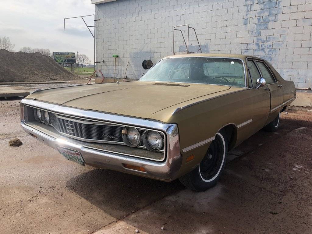

I guess what is the difference between the sedan and hardtop? I have read through some of the other threads. IMO they haven’t helped a 100%. Which is why I just made one. Here is a couple pictures of my car.
That is a sedan. When you roll down the windows, there is still the metal frame around the opening on each door, and there is a solid B pillar between the doors that goes all the way from the sills to the roof. If it was a hardtop, once the glass is rolled down there is one big opening from the A pillar by the windshield all the way back to the thick C pillar at the rear.
