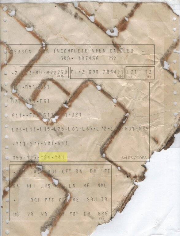

A while back I got some parts from this car. I ended up trading a old IHC 1 ton for the 69 carcus.
I did the swap today. I removed the back seat and found a fairly intact piece of paper. I must say I've never seen anything like this.

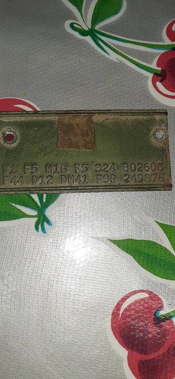

I posted the fender tag earlier in the year and received a request for build sheet if one existed.
I'm not much of a 4 door guy but I would have liked to have gotten my hands on this one when it was in better shape.

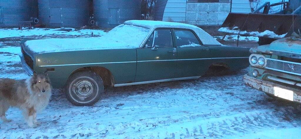

is that a 60 dodge pickup or a panel i see?
Fargo halfton
D12 on the tag did you pull the pedals?
Yes. On the faint hope clause
I put a ad on kijiji looking for fuselage pedals. This guy contacted me. He said he had a 69 polara and wanted 100 bucks for the pedals if I helped remove them. I must admit that i expected to see a 67 or 68. I went the next day to find a interesting 69.
Manual steering
Manual brakes
Manual trans
Radio delete
Super light
2 tone paint
@rd92west -- thank you for posting the tag and sheet of DM41F9R249876 and thank you for the story too!
Am I correct that this F5 green car had a W1 painted white top (as opposed to V1W vinyl top)?

Yes white painted top.

The upper and lower boxes on DL43G9R286471's broadcast sheet are marked "???". I guess that's because nobody knows what information they contain?

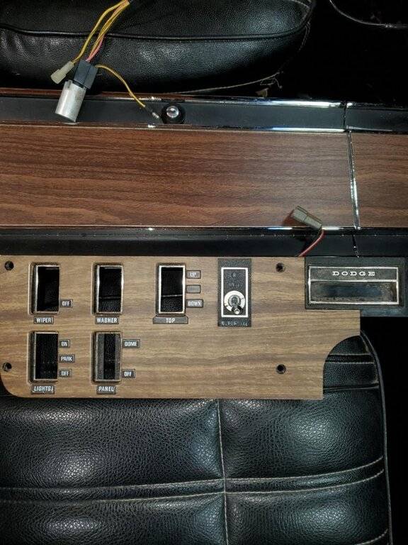

@rd92west -- @polara71 says that you do not need a new bezel. See Dave's thread on the superlite, to which I linked to above. The convertible dash bezel fits all convertibles with and without superlite. You're gonna need the little black bezel and switch.
There are two holes drilled into that woodgrain bezel, the light and the switch slide through. Dave says you can't get the positioning wrong because the template is on the back of the large bezel.

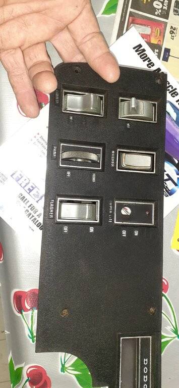

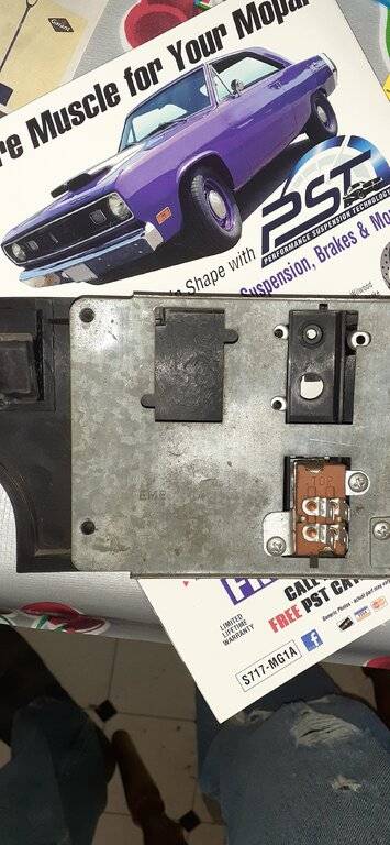

I really appreciate the suggestion.
Here is the bezel from the polara.
Yes is has the cutout in the metal plate for a extra switch.
It's the front that concerns me. If I was to add the top switch I would not have the fake chrome outline around the border of the hole, and not have "top" printed nor the "up/down"
Yes it's completely doable. I do lots of weird **** but I just cant come to grips with this.
Also the backside of the bezel doesn't have the plastic receptacles for the screws that would hold the extra switch In place.
Yes I could get the extra switch in if my life depended on it. Most people wouldn't notice it. But it would slowly but surely annoy me.
My Monaco bezel is black plastic as well.
@rd92west – unless I am mistaken, what you are showing me is the sedan dash panel. AFAIK, Dave is talking about the convertible dash panel. I really really wish he were still a member here, as he is trying to help you but is no longer a member.
As to the upper box in the line "3RD - 187466" the six-digit number could be a sequence number like the one printed in the upper left corner of US broadcast sheets, as it's close to 100,000 less than the SPN, "286471" in this case. Same on the other two Windsor broadcast sheets that have been posted.
